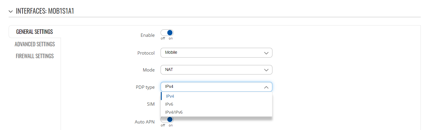

If you’re using Mobile SIM card as your internet source, you could change the PDP type of the mobile interface to IPv4 only by navigating to Network → WAN, then edit the mobile interface. On the PDP type filed, select IPv4 only.

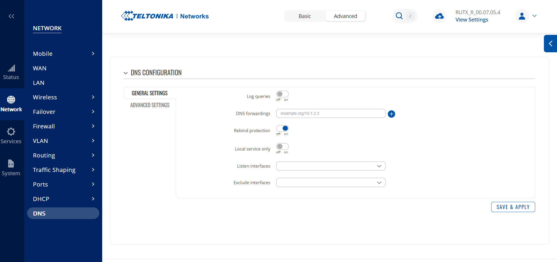

In addition, if you know the IP of the VPN server you were using, you could manually put it in the DNS Configuration of the router. Navigate to Network → DNS
