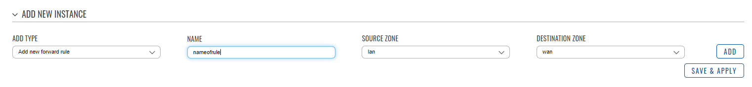

You can block particular client by firewall on RUTX11, you need lookup to Network → Firewall → Traffic Rules.
  1. Firewall rule location: image
  2. Adding new rule:

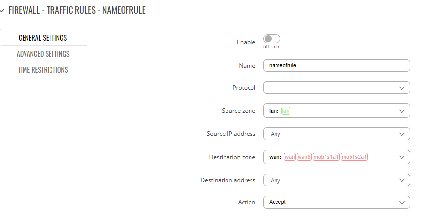

  3. Configure addresses to forbid access:
Additional information: Blocking Internet Access for LAN Clients - Teltonika Networks Wiki (teltonika-networks.com)
