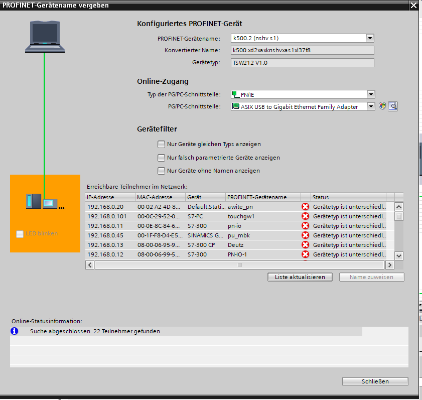

im having a project at customer’s site wich i planned with 5x TSW212 on a Siemens S71513. GSD file is imported and the Switches ar configured in TIA Portal.
When i try to assign the profinet names, not a single TSW is discovered.
Firmware is up to date (TSW2_R_00.01.06.3)
Did i do wrong to set up the PLC-Network to VLAN 10? or have i rather to use VLAN1?
Thanks!
Thank you for reaching out.
Firstly, as there have been some improvements included in the latest TSWOS release, could you please upgrade your devices to version 1.7 and check if the issue with profinet device discovery still persists?
