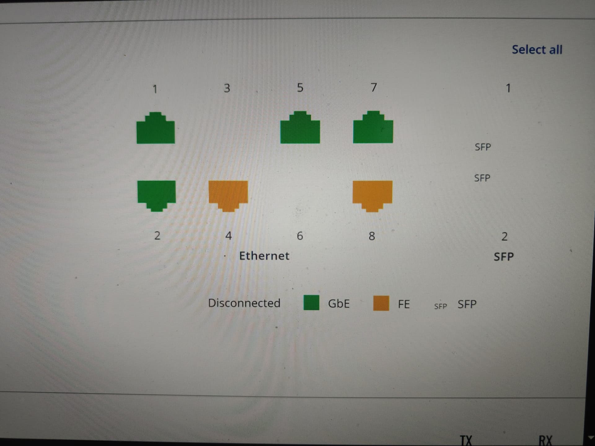

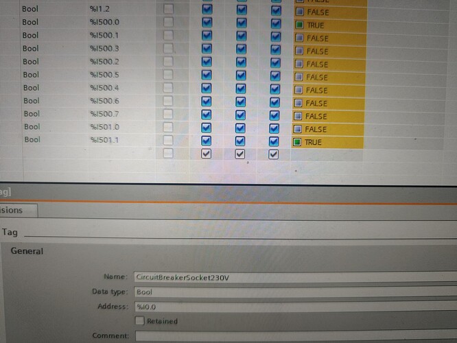

Please provide information regarding profinet communication in the TSW212 switch. I am interested in the word DEVICE STATUS. There are 10 bits there, the meaning of which I do not know. I assume that this is information for each port, but what information. I have 6 ports connected and only 2 in DEVICE STATUS are true. The second issue is whether there is any way to speed up the start-up of the switch because it is the slowest device in the system and all devices are waiting to be able to establish communication, which in my case is problematic.

Good morning. I’m still struggling with the status word on the TSW212 profinet. I have 6 ports connected, in the port starusoe there is information up. In the status word I only get the “true” bit on bit 0 and 10, the rest is “false”. I have two such machines and it’s the same on both. It seems to me that the status word does not show any ports, but there is nothing about it in the manual.
