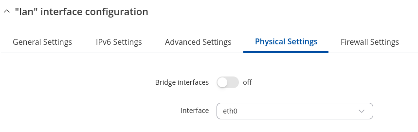

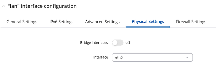

TSW212 jumbo frames?
Does not seem to work?
