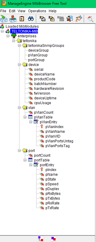

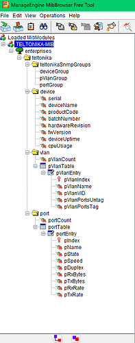

I know one is supposed to download the MIB from the switch itself, and we have done that, but that MIB seems to be only Teltonika’s own MIB, and there is no reference to any standard MIBs being supported.

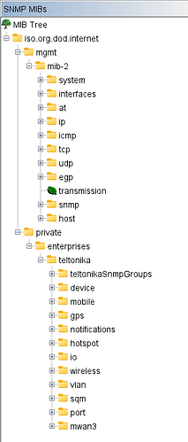

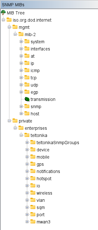

For reference, here’s how the MIB tree should appear when loading the TSW MIB file into a browser:

I made sure SNMP was activated, and then downloaded the MIB again. Alas, no change , it still has no standard MIBs included, unlike in the screenshot you shared. It’s just those Teltonika OIDs that are on that page you linked to (also no standard ones there). Apart from the LAST-UPDATED and REVISION, the MIB file seems exactly same as the earlier one.
