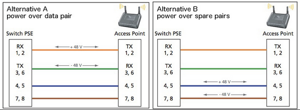

The TSW202 switch uses the 802.3at Alternative B standard. In rare cases, your access points (APs) might not support power delivery on the pairs used by Alternative B and therefore cannot negotiate power. Please check if your specific APs use this standard. Also, try switching the cables, as they might be faulty.
2024-06-12-10-36-28-PoE 802.3af - Alternative A Vs B_ - IPVM Discussions — Mozilla Firefox

I will check (measure) what pairs TSW 202 transmit power, Volt and Amper. Thank you.
Hello, I have the same problem. I have a “Alternative A” device that I want to connect to the TSW202. Is there a way to convert from “Alternative A” to “Alternative B” or do I need to buy another switch? Does Teltonika provide “Alternative A” switches?

If you need to convert “Alternative A” to “Alternative B,” you can look for a converter. However, if you need to use more than one port, I recommend finding a switch that supports “Alternative A.” Currently, Teltonika does not offer a switch that supports 802.3at Alternative A.
