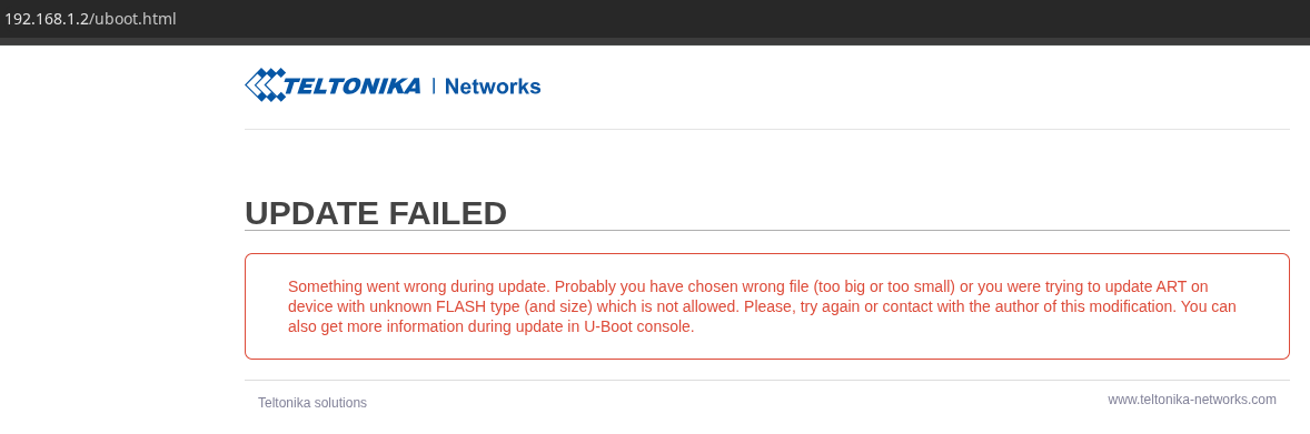

I have run into an issue while trying to update TSW202 in the bootloader menu. Choosing either TSW2_R_00.01.07_WEBUI.bin (downloaded from your site) or an older version doesn’t work. I am attaching a screenshot of the message. Tell me please if you need me to provide further information.
Regards, Frank
Based on your screenshot - you are in the wrong bootloader menu.
Try to use the 192.168.1.2/index.html, instead of 192.168.1.2/uboot.html
