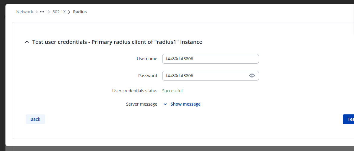

  • Test connectivity → Successful
  • Test user credentials → Successful

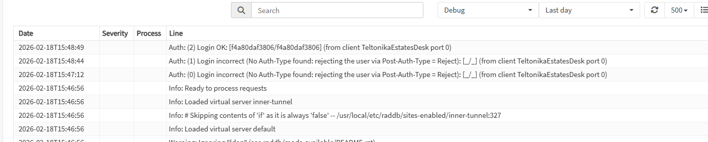

  • Auth: (2) Login OK: [MAC Address/MAC Address] (from client TeltonikaTSW202 port 0)
  • Live 802.1X authentication on port → Fails
  • Port status shows: Unauthorized
On the RADIUS server side, the log shows:
  • Login incorrect (No Auth-Type found: rejecting the user via Post-Auth-Type = Reject)

Successful Test (Teltonika “Test user credentials”):
  • Access-Request contains:
    • User-Name = MAC Address
    • User-Password = MAC Address
  • Result:
    Login OK: [MAC Address /MAC Address ]
Failed Live 802.1X Authentication:
  • Result:

The key difference observed is that the “Test user credentials” function sends both User-Name and User-Password, whereas live 802.1X authentication appears to send only User-Name.

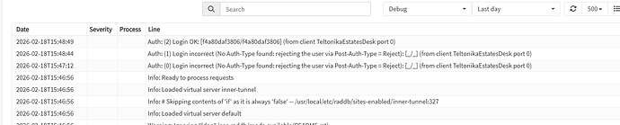

You’ll see the 3 tests bellow 2 are 802.1x port aut failing then the test function accepts
