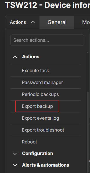

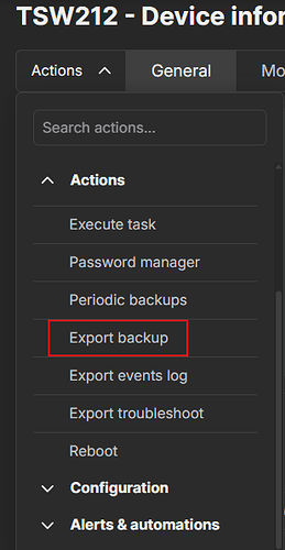

I’ve recently enabled automatic periodic device backup in RMS for all our production devices, and in few days we found the TSW212 running TSW2_PROFINET_R_02.01.06.3 switches restart the bridge (twice) on creating backup:
