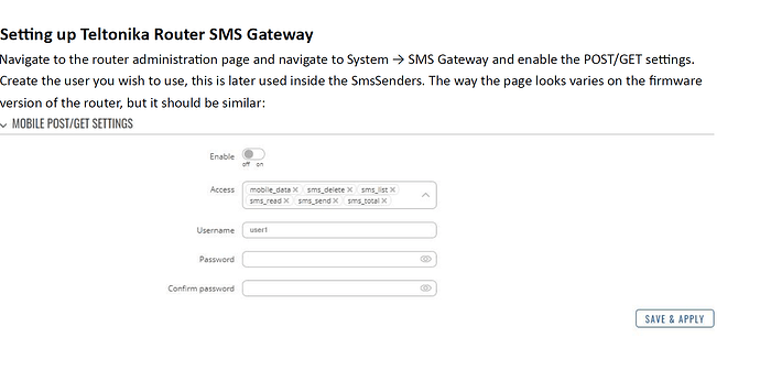

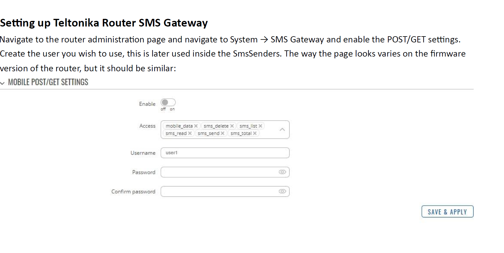

Trying to set up this router with a 3rd party driver in Niagara to text alarms
To use the Mobile POST/GET service, your firmware must be older than 7.14. If your firmware is newer than 7.12, you will also need to install the Mobile POST/GET package via System → Package Manager.
