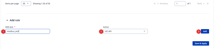

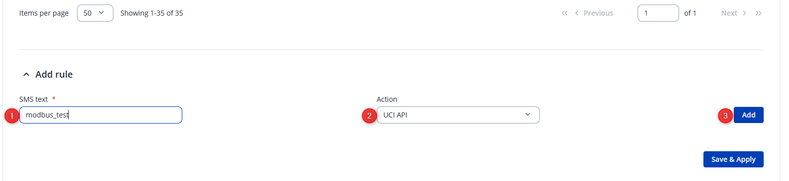

  1. Scroll down and click Add to create a new rule.
  2. In the SMS text field, enter the keyword that will be used as a command in your SMS messages — for example, modbus_test.
  3. Under Action, select UCI API, then click Add.

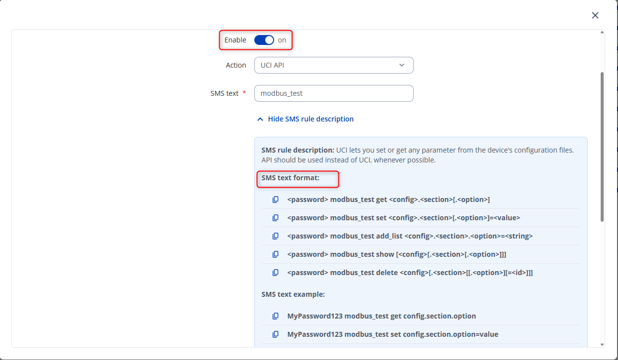

After clicking Add, a new window will appear with additional settings and a description of the rule. Make sure to enable the rule. You will also see examples of how to format SMS messages correctly.
The text entered in the SMS text field will replace the UCI command in your message.
