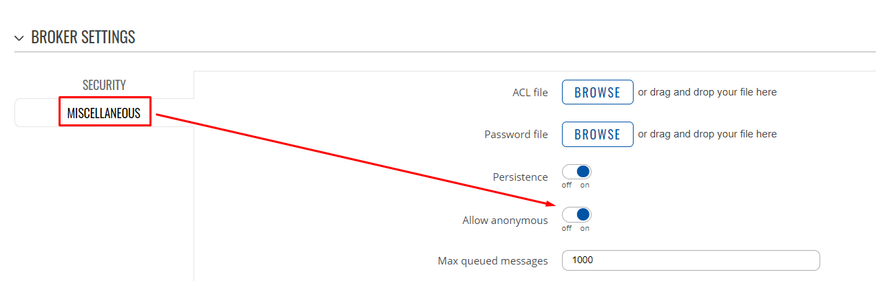

If you are using the broker without TLS/password, make sure that you allow Anonymous connections on the broker:
Also, after enabling anonymous access, navigate to System → Administration → Access Control → Security and make sure that there are no IP blocks on the MQTT port (1883).
