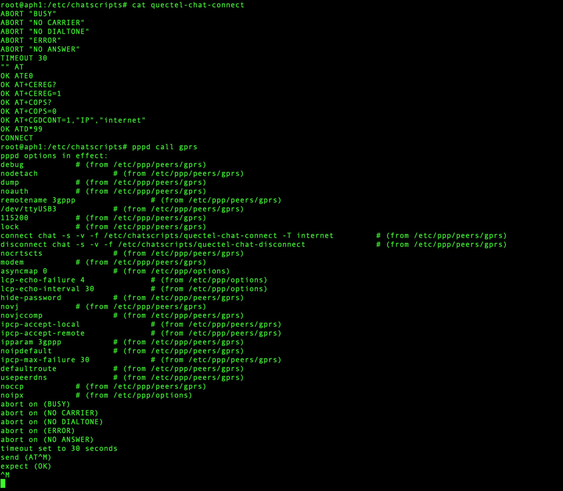

Please note, that communication hangs on very first AT command after the TRM240 was reconnected and booted (PWR and LTE leds are lit, NET led is blinking). See screenshot below:
Yes, it is my mistake, it should be:
ABORT "BUSY"
ABORT "NO CARRIER"
ABORT "NO DIALTONE"
ABORT "ERROR"
ABORT "NO ANSWER"
TIMEOUT 30
"" AT
OK ATE0
OK AT+CEREG?
OK AT+CEREG=1
OK AT+COPS?
OK AT+COPS=0
OK AT+CGDCONT=1,"IP","<your desired APN>"
OK ATD*99#
CONNECT
I would advise rebooting both devices too.

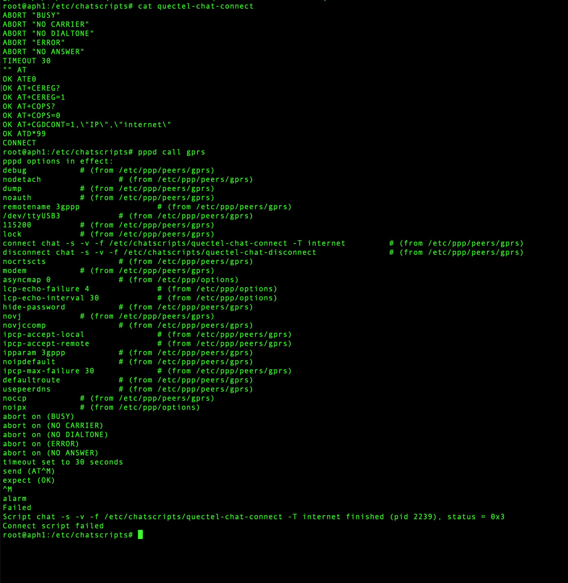

Rebooted both devices, applied corrected script. The problem is still the same. Hangs after first AT command.
Note, I tested this on two new RPis and two new TRM240s. This screenshot below is after fresh reboot of both RPi and TRM240 devices:

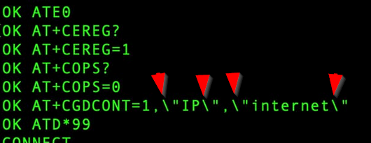

I’ve noticed there are still some errors in the script. There are escape characters in this line:

Thanks, I corrected that too already - please see my message and screenshot here:
I power-cycled both devices.
The SIM card is default one from PLAY Poland network, we tested this with iPhone and the APN was set to internet
I also checked SIM card slot to confirm it is seated correctly.
I am going to try another SIM card from different operator to confirm if that is an issue.

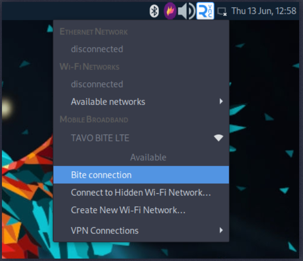

I doubt this is a TRM240 issue, as the connection is definitely possible. I recommend trying other Raspberry Pi images that don’t require CLI setup. Images like Ubuntu, Parrot, or others have automatic modem detection (though sometimes the APN needs to be entered depending on the device).
Here is an example of it working on Parrot Linux:

We downloaded ParrotOS and will check it there. Where we can find tutorial/documentation how to setup ParrotOS to connect to TRM240 modem? We created new mobile connection, selected provider, APN etc. in System Settings but it does not work (i.e. is not visible in available networks), so we may need some additional steps to make the connection? Thanks.
There is no tutorial because, in most cases, it is just plug and play. The TRM240 should work when connected to a Raspberry Pi with most newer Linux distros, as they have automatic modem recognition and setup, similar to Windows or other computers.
Thanks Marijus, understood and expected so, but unfortunately not in this case. Nothing happens when I plug TRM240 to Parrot OS. I created mobile connection manually via some wizard but it says the connection is not available, and it does not show up in the current network connections list.
