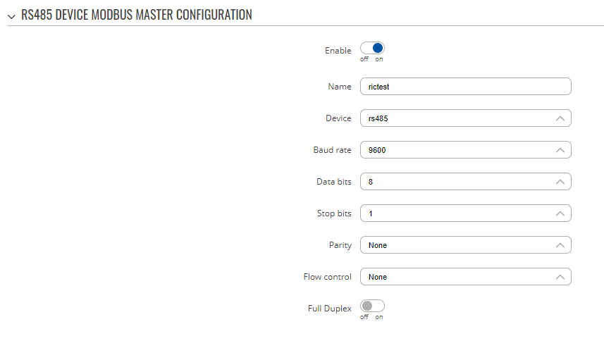

I used this configuration for RS485:
from this topic: Configuring RS485 on RUT955 - Crowd Support Forum | Teltonika Networks.

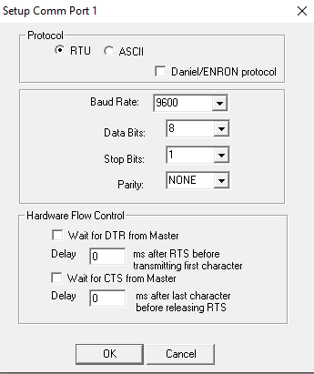

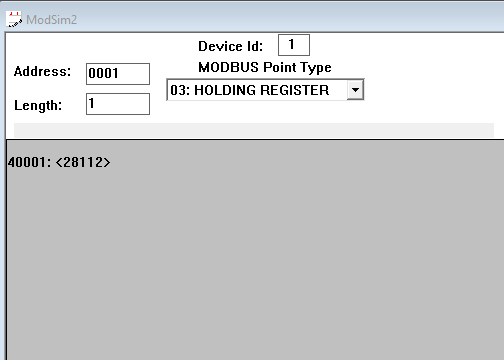

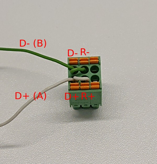

As shown in the image, I connected A+ to D+ on my Moxa device and B to D-. On the other side, I used ModSim32 to emulate my slave device, using COM1 for the USB port:

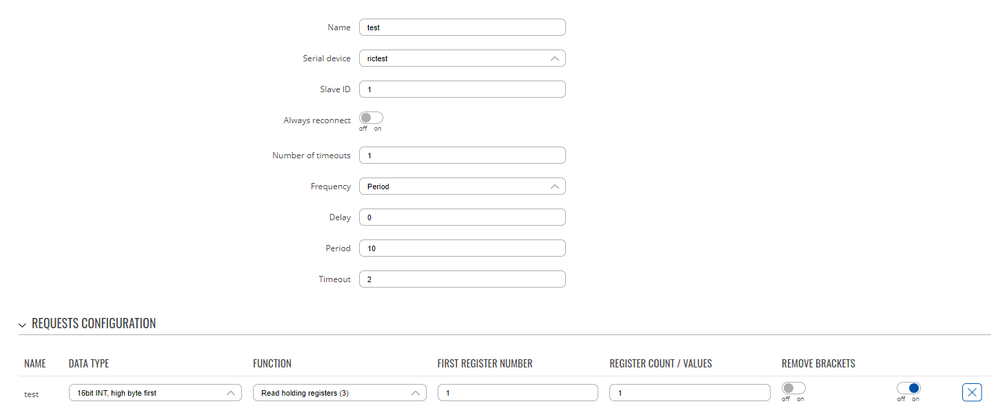

Then I configured the Modbus RTU in the server setup:
When I press the “Test” button, the message “Failed to send test request, daemon is down” appears. What am I doing wrong?
Additionally, why doesn’t it allow me to select the COM port for serial communication? Could you help me resolve these issues? Thank you for your support.
