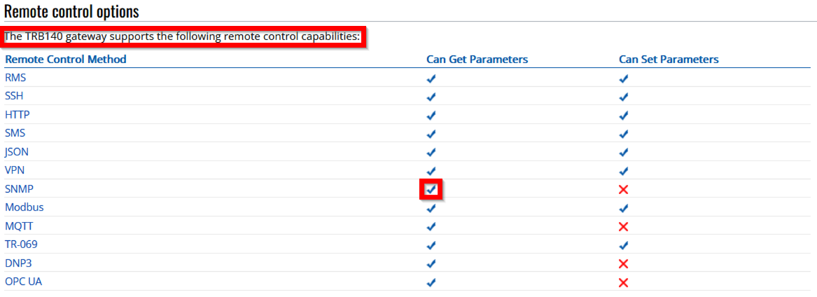

Unfortunately, we have not been able to make the TRB140 receive SNMP trap messages or read SNMP MIB of other assets from the TRB140. This makes us wonder if the TRB140 is even able to get SNMP parameters from other assets? According to this link it should be possible.

On the page you referenced, it provides remote control options for TRB140, stating that TRB140 information can be accessed via SNMP. Therefore, it can be used as a trap, but to provide information to an SNMP manager. In general, our router acts as an SNMP agent.
For temperature monitoring, you may need to explore alternative solutions. Our devices themselves can monitor their internal temperature, accessible via CLI/SSH commands. A script could be written to trigger actions based on certain temperature thresholds.
