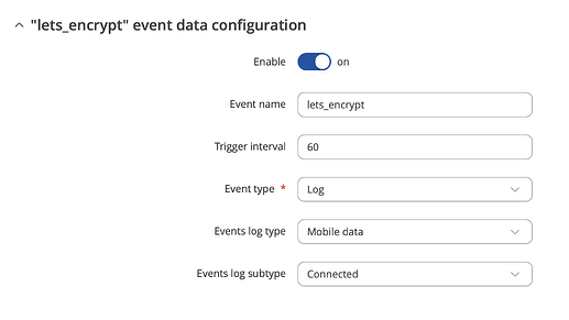

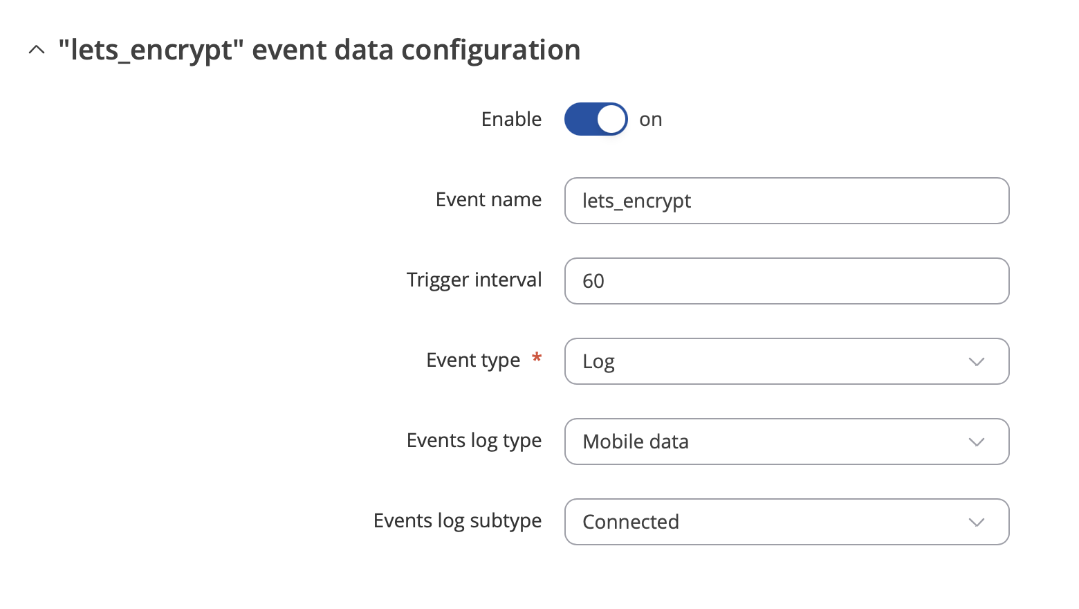

based on this GitHub repo I have created a small script to get a ssl certificate. I would like to call my script from the Event Juggler. Trigger is Connected Mobile Data.
Unfortunately nothing happens once Mobile Data is connected.
In general the trigger seems to be working. I changed the action to send an SMS as soon as mobile data is connected. So I assume that the issue is located in my script.

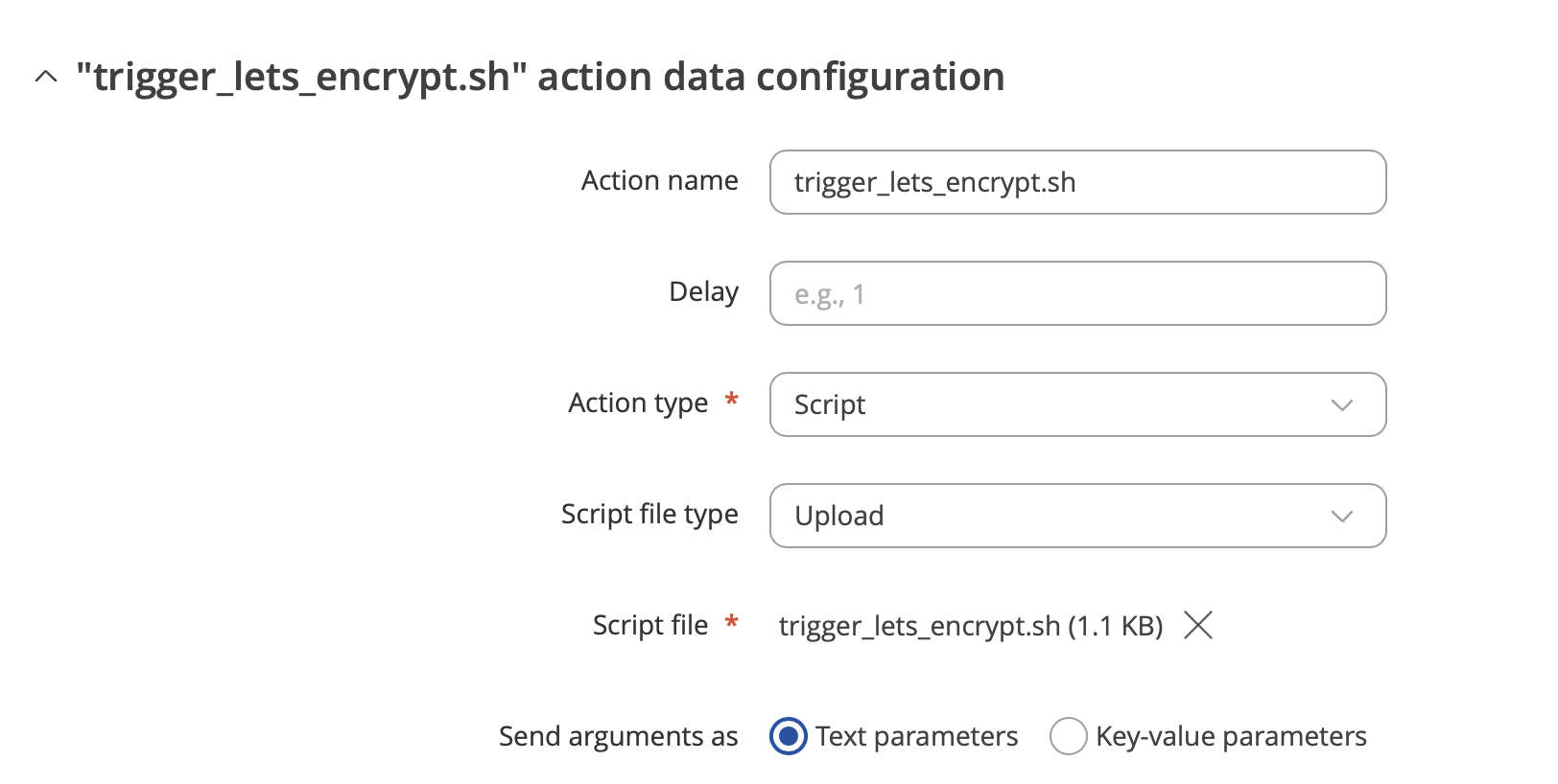

Instead of placing my script in /etc directory I have used the upload functionality in Event juggler:
