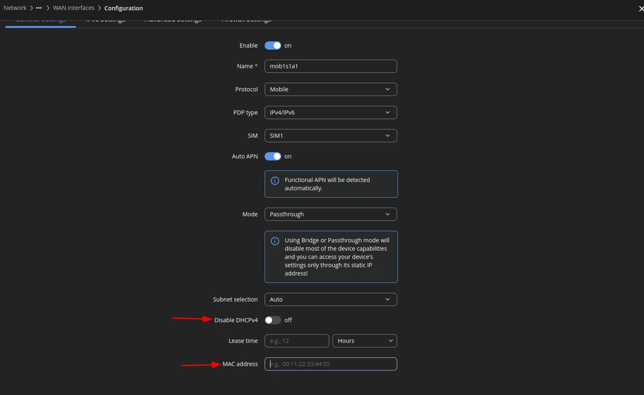

Hello, @mik ,
After analysing your troubleshoot file, it seems that you have enabled Disable DHCPv4 .
Could you please try this configuration to see if it helps: turn off Disable DHCPv4 and enter MAC of device in LAN to which you want to get mobile public ip as shown in screenshot?
Please let me know how it goes,
All the best,
Hi @Vilius
already tested: doesn’t work
(we make many hours of test with your collegue in May)
do you mean: AUTO + firewall port MAC ADDRESS
or: P2P + firewall port MAC ADDRESS
regards, michele
