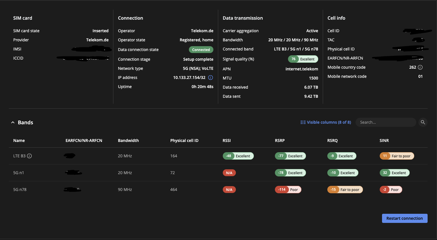

I’m using a TRB501 on the Telekom network with a 5G NSA connection. I noticed that for the 5G bands, the RSSI value always shows N/A, while LTE still displays an RSSI value normally. Other metrics such as RSRP, RSRQ, and SINR are displayed correctly and the connection itself works fine.
What makes me think this may be firmware-related is that the issue started after updating beyond TRB501_R_00.07.20. I do not remember seeing this behavior on earlier firmware versions. Since then, RSSI for 5G NR consistently shows N/A.
I’ve attached a screenshot for reference. Could someone confirm whether this is expected behavior for newer firmware versions? Was RSSI intentionally removed/not exposed for 5G NR, or could this be a regression/UI issue introduced after TRB501_R_00.07.20?

I’m having the same issue on TRB500 with TRB500_R_00.07.22.3 firmware.
RSSI shows as N/A.
