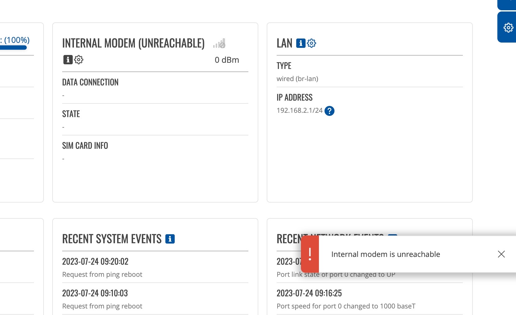

It started with a problem to ping the router, log on to gui thru Ethernet etc. I restartet, reset etc without help. USB-cable from a Mac made me log on to GUI, and i can se Internal Modem (Unreachable) See picture.

It seems like a hardware failure. Could you check your PSU? If there are no issues with PSU, then I would recommend that you reach out to your designated sales manager or the reseller from whom you acquired the device in to initiate an RMA procedure. You can find more information abour RMA here.
