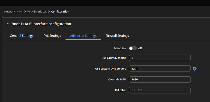

I recommend selecting all Interfaces, as this will allow you to trace packets as they enter the TRB500 through the LAN interface (from the Blackmagic device) and exit through the WAN/Mobile interface. This should help determine whether the TRB500 is dropping or fragmenting any packets.
You can also try reducing the MTU on the mobile interface. To do this, navigate to Network → WAN , edit the active interface and under Advanced Settings, adjust the Override MTU value. I suggest testing values such as 1420, 1400 and 1360 .
