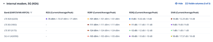

Majority of time, data network is acceptable and router correctly answer to SMS question.
Here is the setup :
  • Model RG501Q-EU
  • FW version RG501QEUAAR13A01M4G
  • Firmware version TRB500_R_00.07.18.3
  • Kernel version 4.14.336
  • external antenna PR1KC647 5G MIMO
  • wan in passthrough
Can anyone help me finding what can be do to solve that issue ? Can it came from something that is not well setup or can be caused by the network provider stability or something bad with the router hardware itself ?
