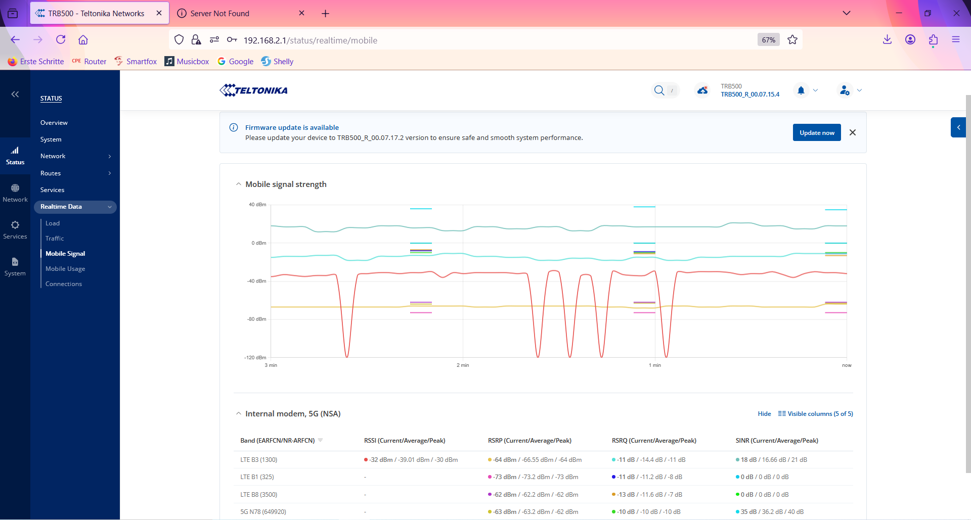

Thank you very much for clarifying the details,

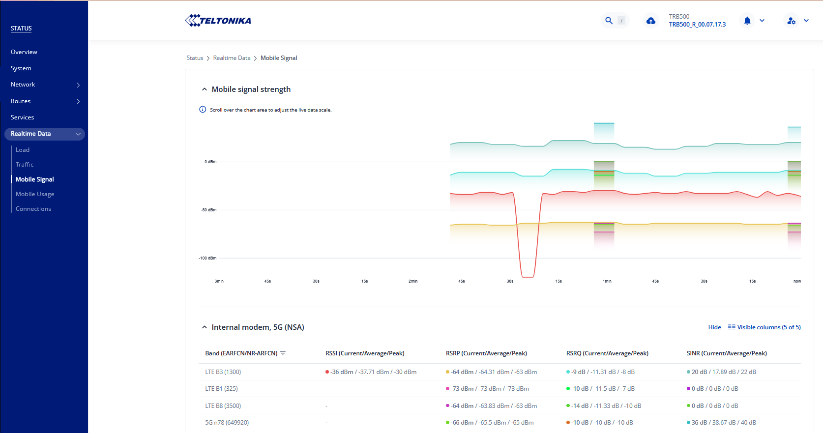

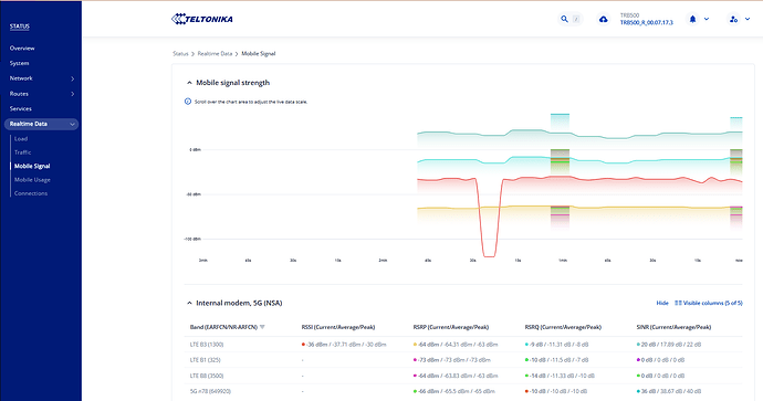

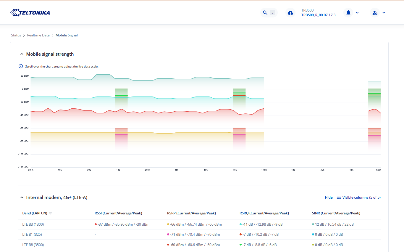

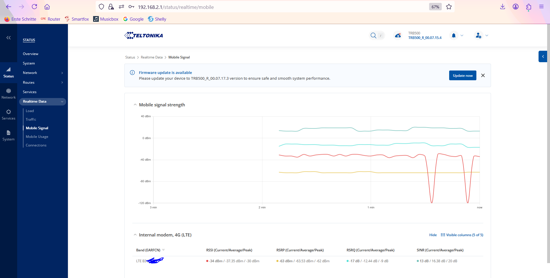

Looking at the graphs, the jumps seem to be very sudden, then occasionally go back to normal, and then jump again. Just to check this off the list, could you please upgrade your firmware to 7.17.3 and see whether the issue still appears? Here’s a link if you want to download the firmware manually: TRB500 Firmware Downloads - Teltonika Networks Wiki
Alternatively, you can head to System → Firmware → Update Firmware and select to update from server.
the issue is still happening after the update.
See picture below:

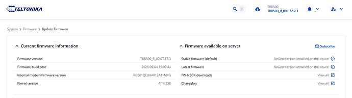

Good Morning,
I’ve tried a different sim card (LTE only) and the behavior didn’t change that much.
I’ve also attached a screenshot of the modem firmware used.
Br,
Daniel.
