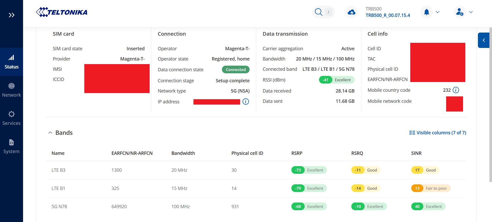

I’ve decided to go for a TRB500 because I live near a mobile tower I do have a good 5G/4G signal. Before installing the TRB500 as intended I’ve done a few performance tests in a good environment to see if the device is working well. Unfortunately, I’ve always achieved less than 240 mbits in download speed - even though I’ve achieved the full download speed with other devices (600 mbits). The upload speed is good though.

sup, try this: Band Lock - Teltonika Networks Wiki
since you’re getting fair to poor/good values on some signal values that could mess with the speeds.

I forgot to mention that I’ve tried locking the bands earlier.
Fortunately, my e-mail inquiry was received and I got support from Teltonika.
I have followed their advice and got very good results.
Adjusting the PDP typte to IPv4 only and setting the APN selection to manually made a huge difference.
Now I am able to achive the maximum download/upload speeds of my Sim-card (600/60).
