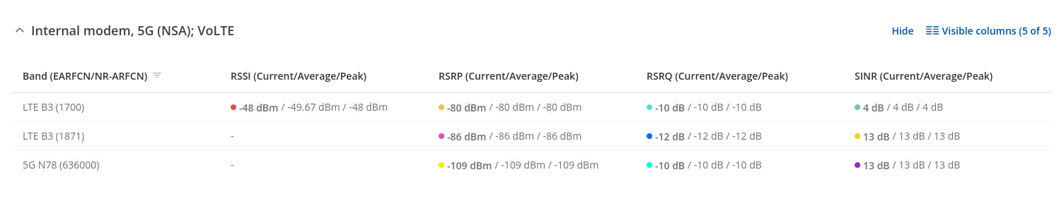

I also enabled the band locking to the bands, which were automatically chosen after a device reboot. These are B3 for LTE and N78 for 5G. For UMTS I selected all of them but these aren’t used anyway as far as I can tell.
See the attached screenshot for the used bands and the signal quality.
I’ll have the changed settings applied for 1-2 days now and get back to you with an update…
