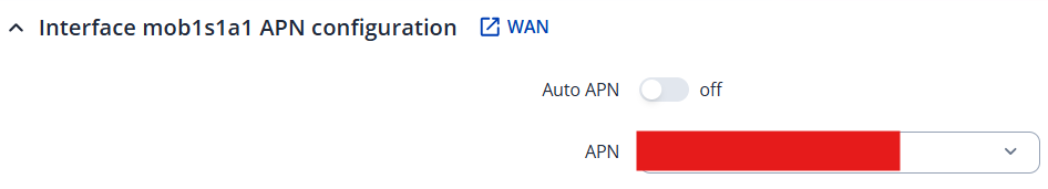

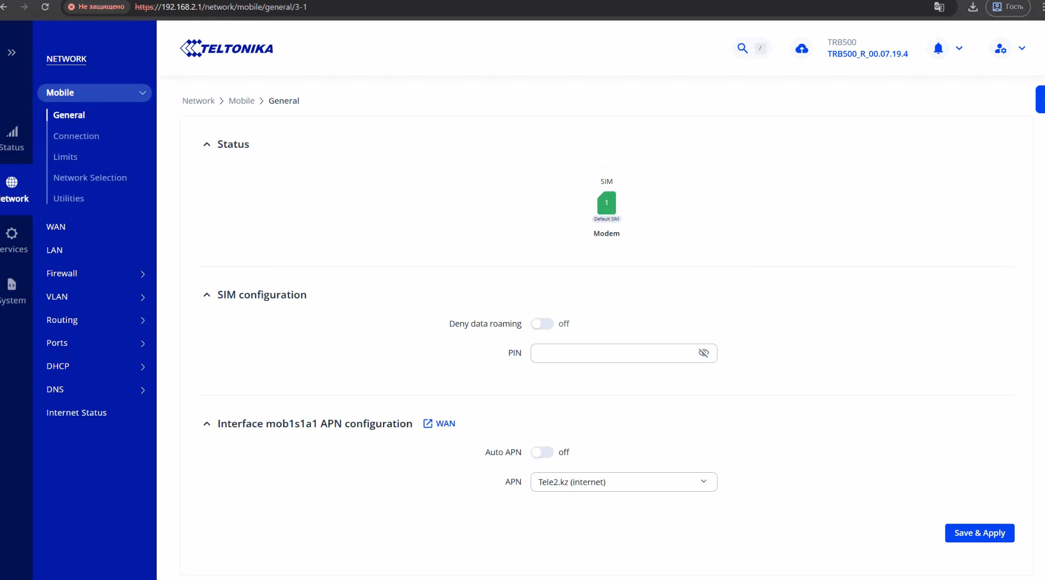

Additionally, please verify that the APN is configured properly for your mobile operator. You can check this by navigating to Network → Mobile → General.

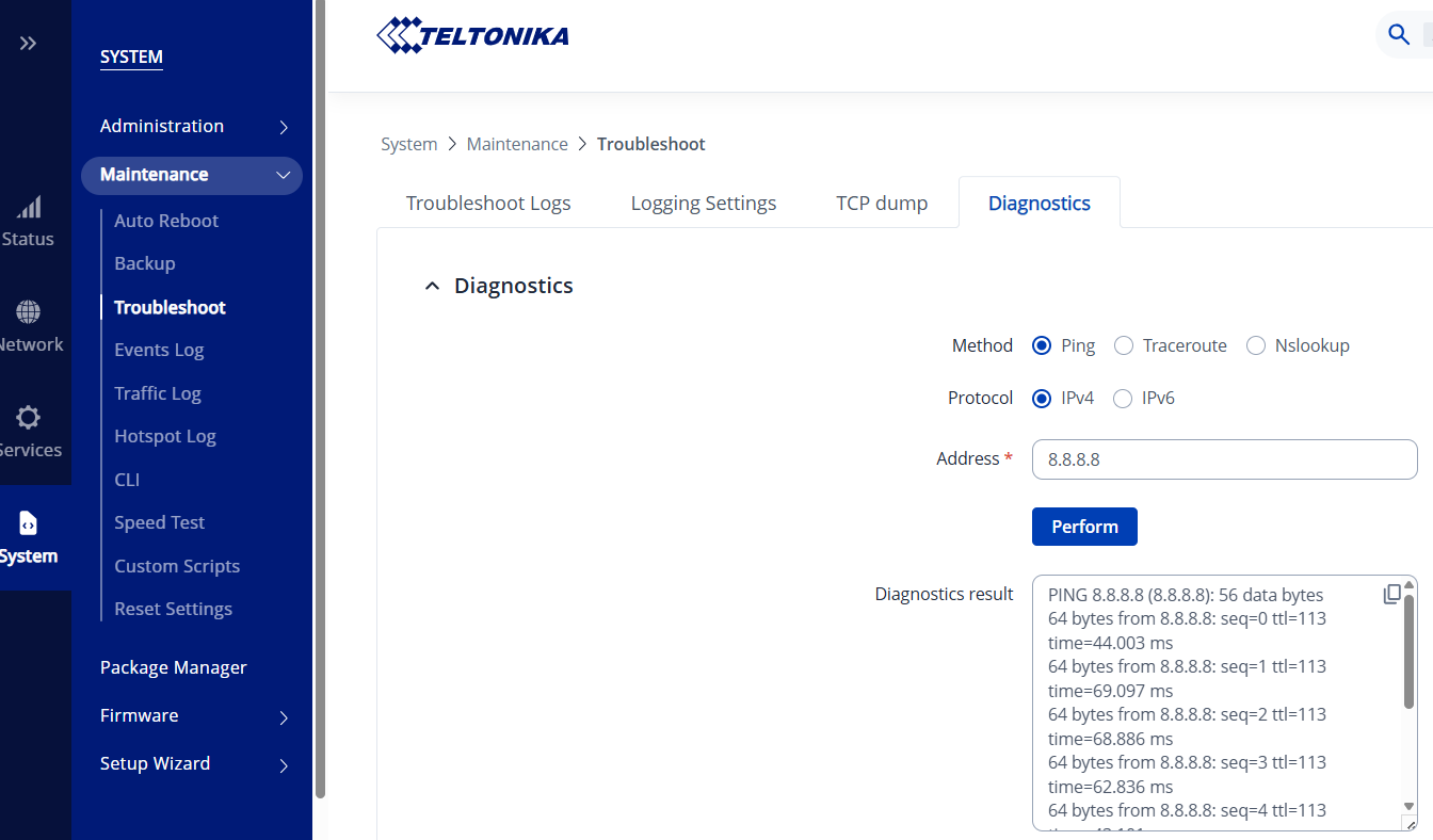

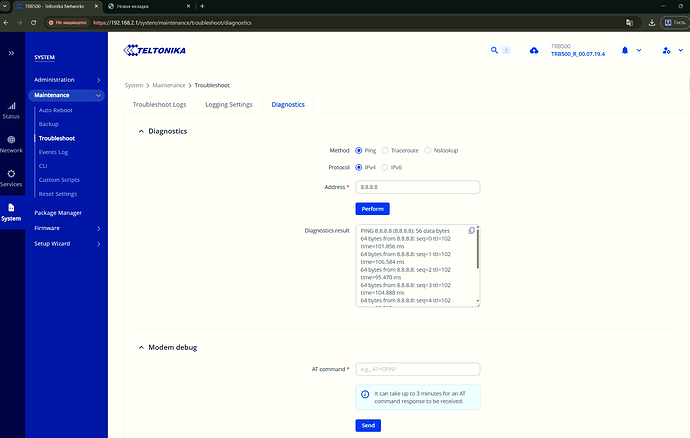

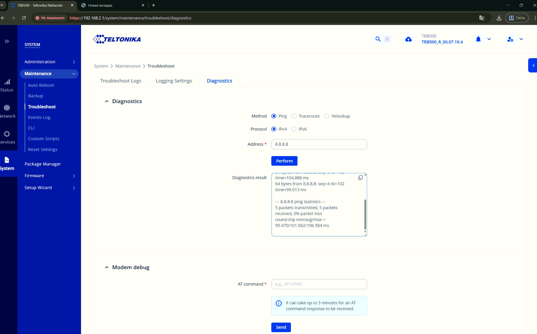

Could you also try pinging 8.8.8.8 and then google.com, and share the results with me?
You can do this by going to System → Maintenance → Troubleshoot → Diagnostics

We also checked the APN, it matches the mobile operator.
