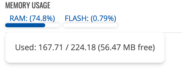

Is the device reachable by other means? Can you ping it? If you are using RMS, is it reachable through RMS? Does the device have any specific configuration that might use excessive RAM?

I use path true, I have turned off rms. No, because of the usage I need less ram.

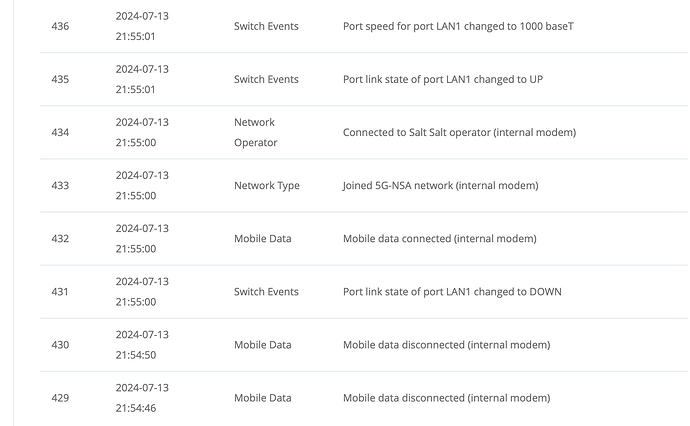

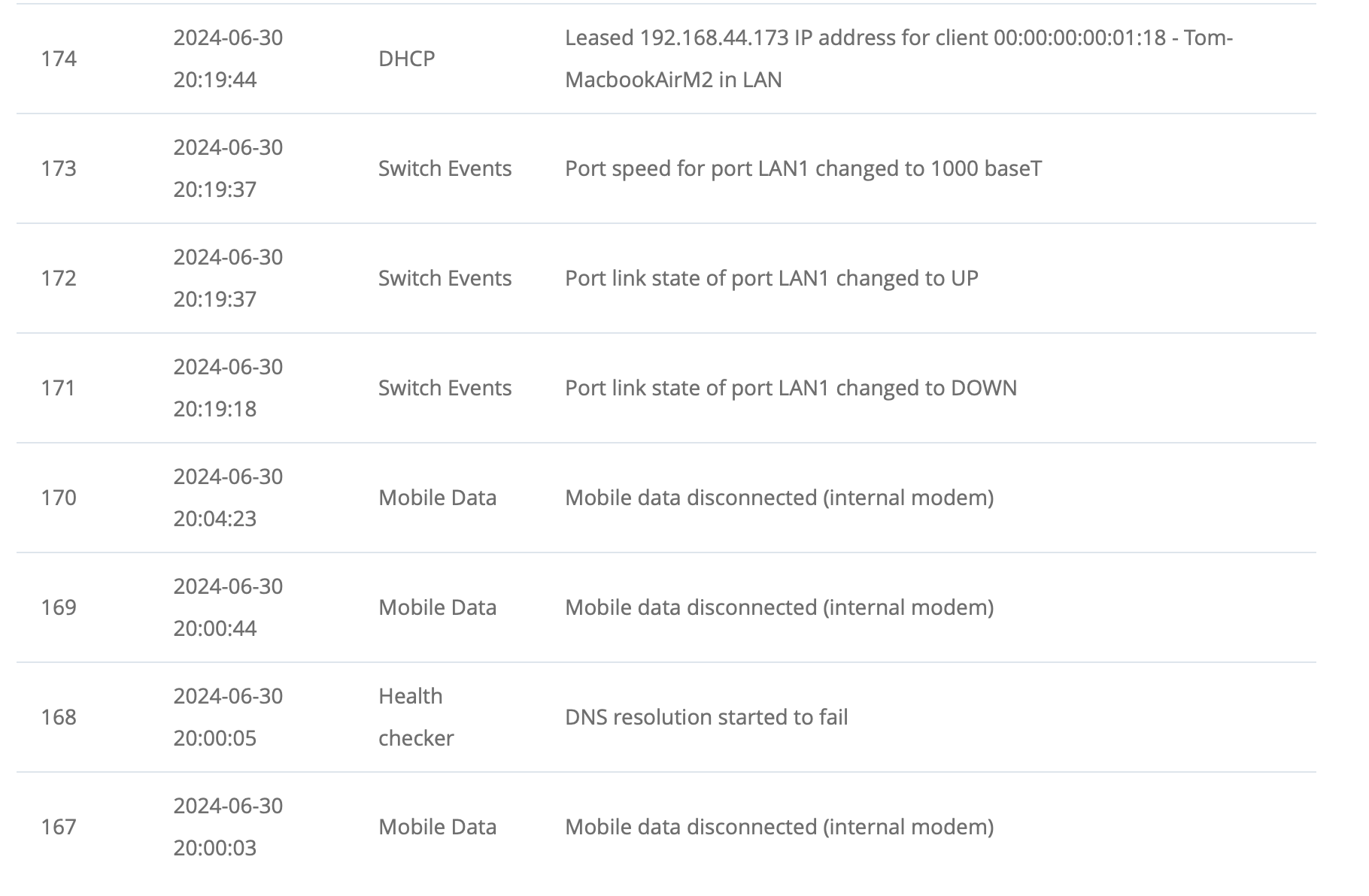

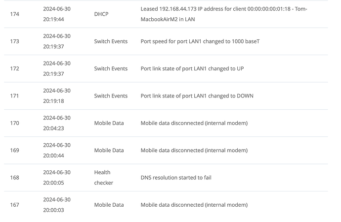

After it stopped working I connected my notebook, you can see it in the log.
It looks to me like the GSM was interrupted and the modem then froze instead of reconnecting. see log.
You mentioned that the current operation needs more RAM, which is why you turned off RMS. Can you explain what this operation is? Could it be causing mobile disconnection issues?
I only need the TRB500 for passthrough and probably need less ram

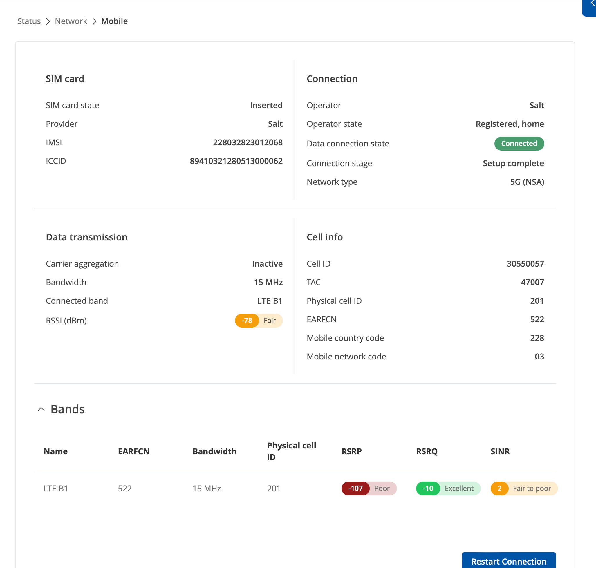

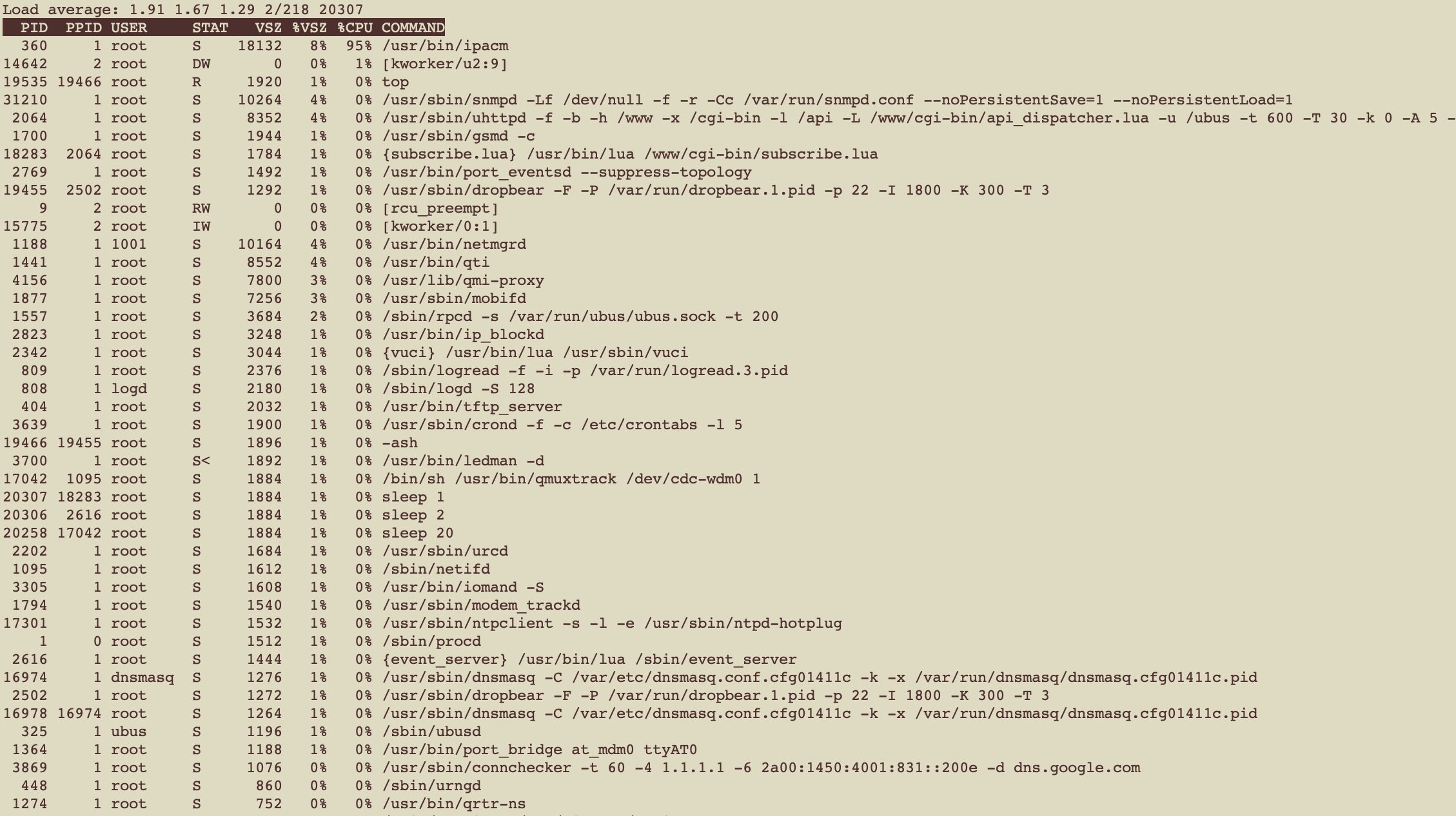

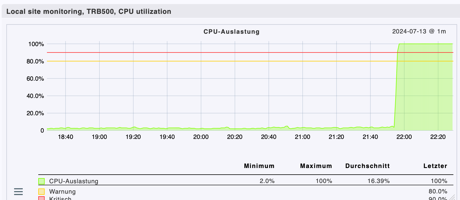

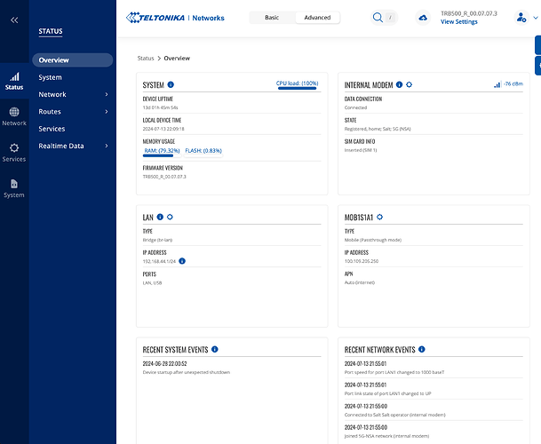

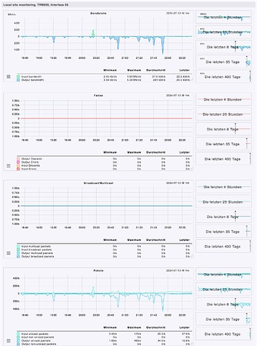

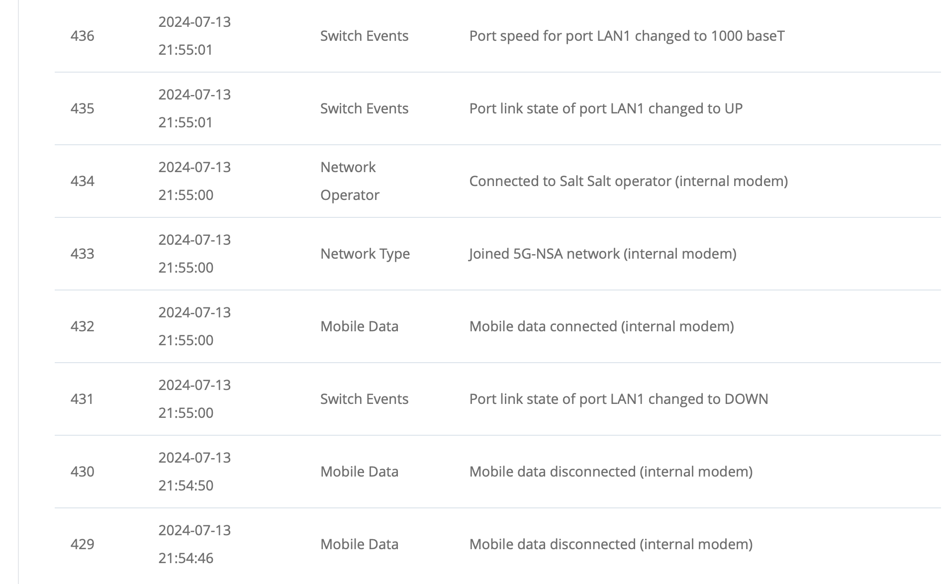

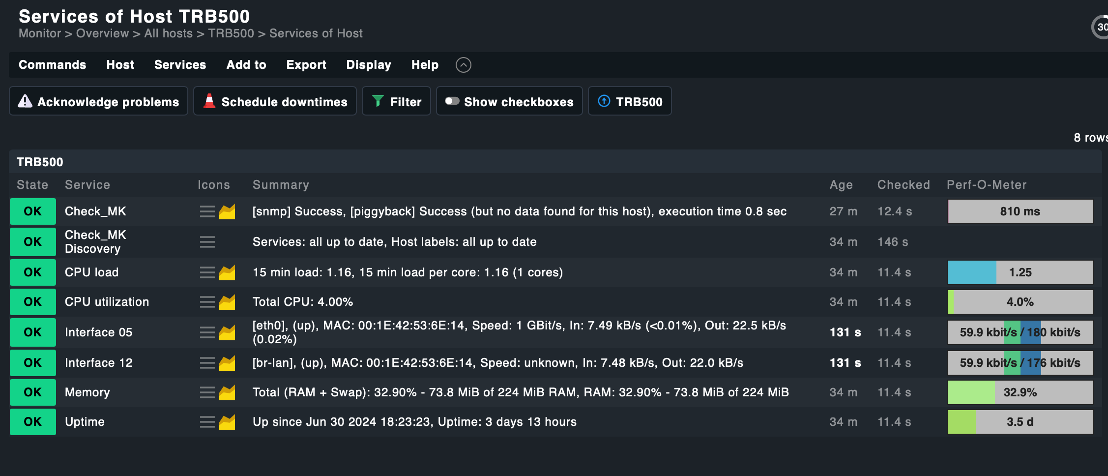

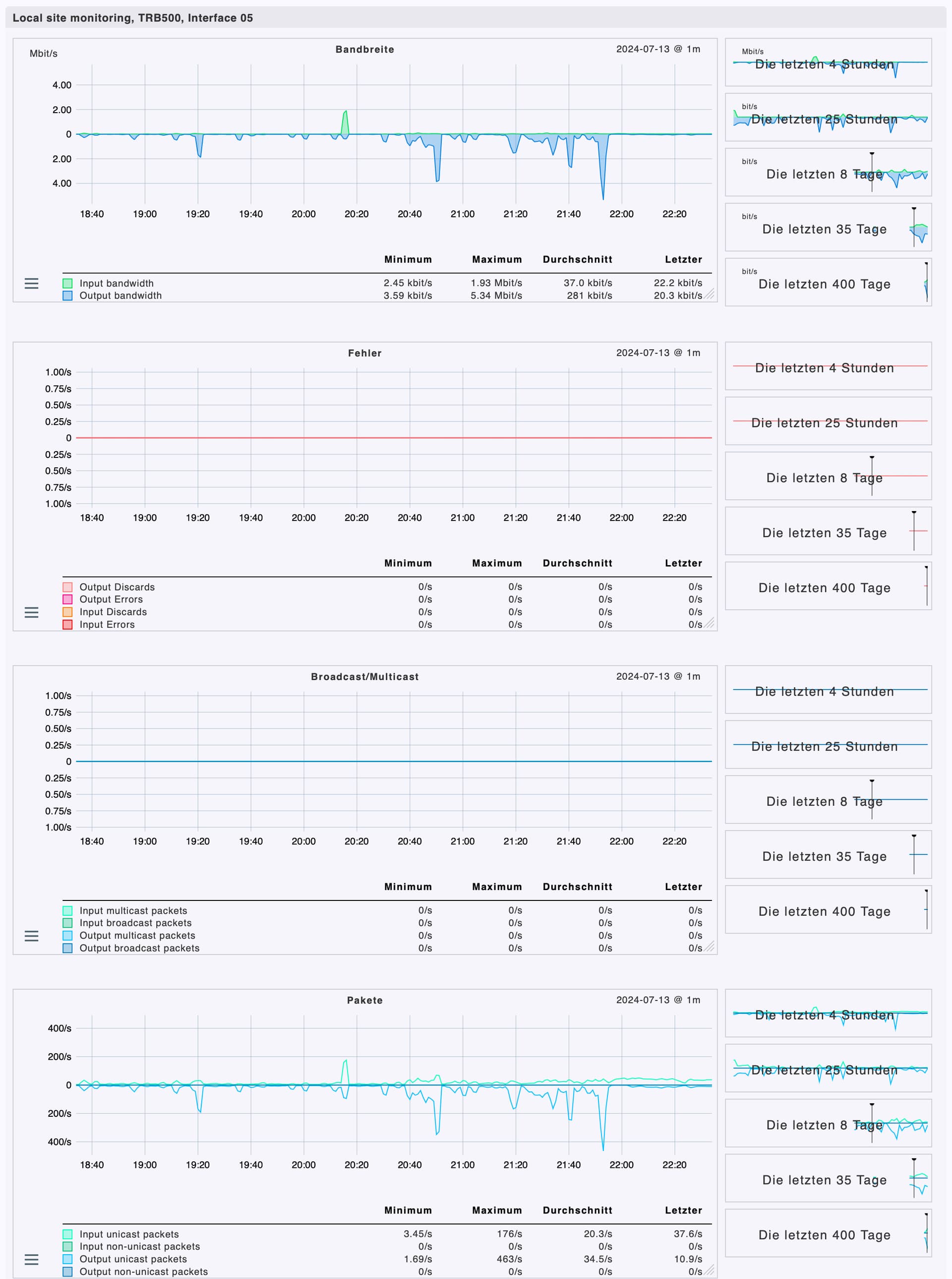

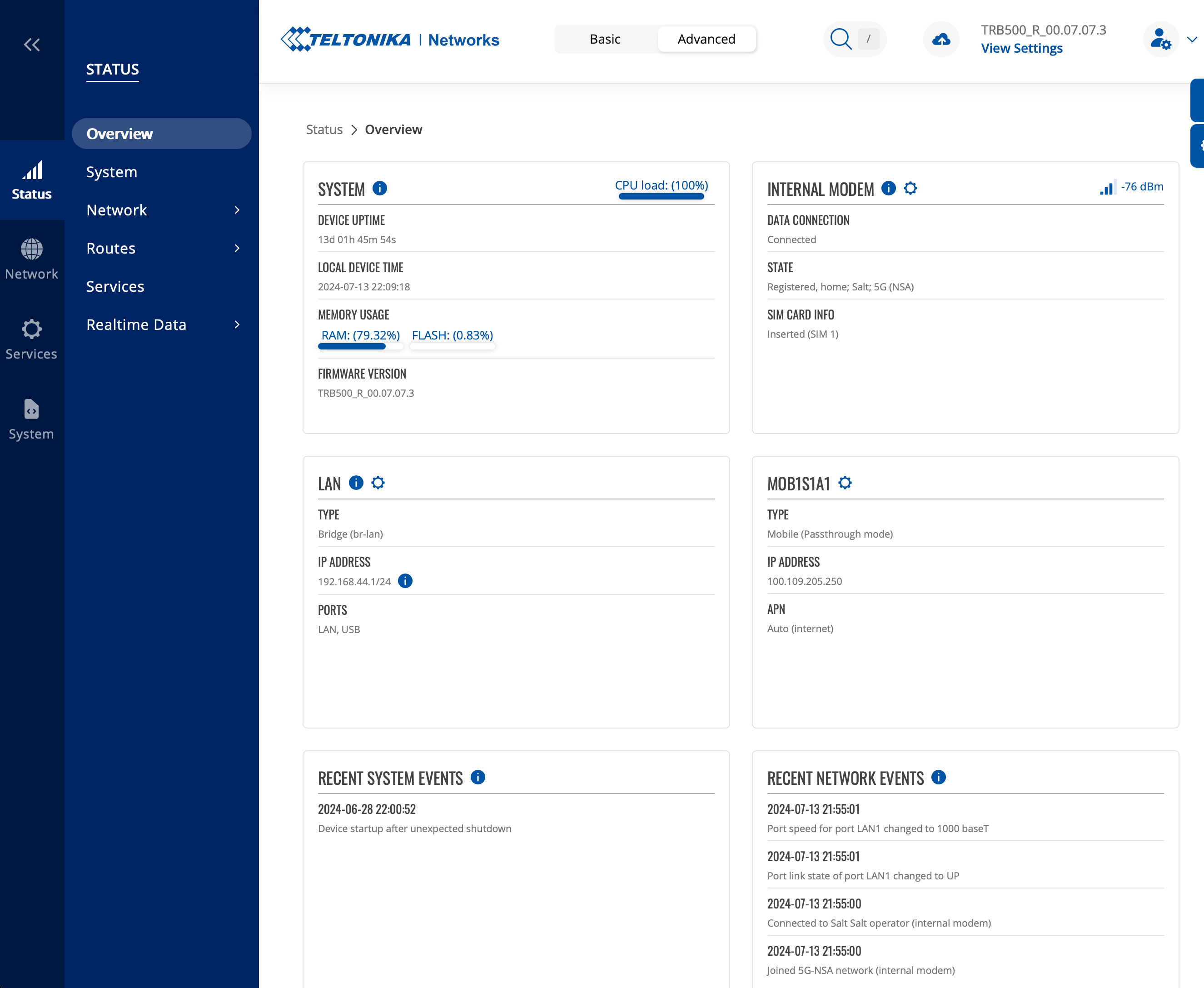

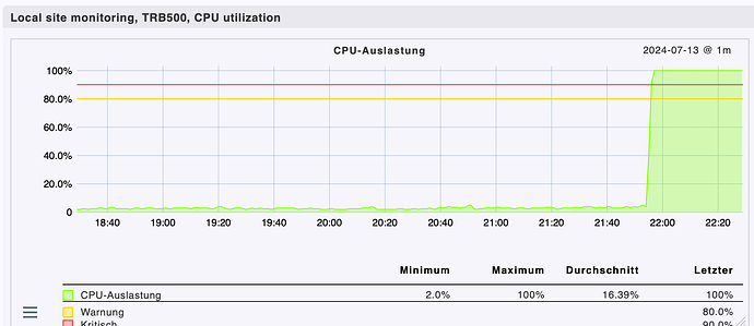

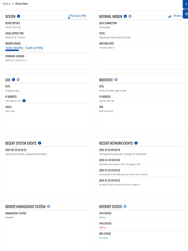

It’s happened again. I’ve now collected all the data. The trb500 ran for 10 days without any problems and then suddenly the connection stopped working. The CPU suddenly had 100% load. see cpu monitoring and system status. At this time the trb500 had little internet load. see traffic monitor. The top monitor shows that the ipacm process was using 95% of the cpu. see top process. Normally it uses around 3% of the cpu. see top process. The WAN status was only with one connection instead of four. Restarting the connection didn’t help either. I then downloaded the troubleshoot file. Then I restarted the TRB500 so that it was usable again. I would be very grateful if you could fix the problem.
