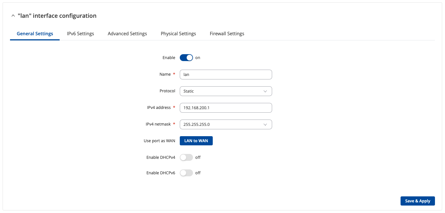

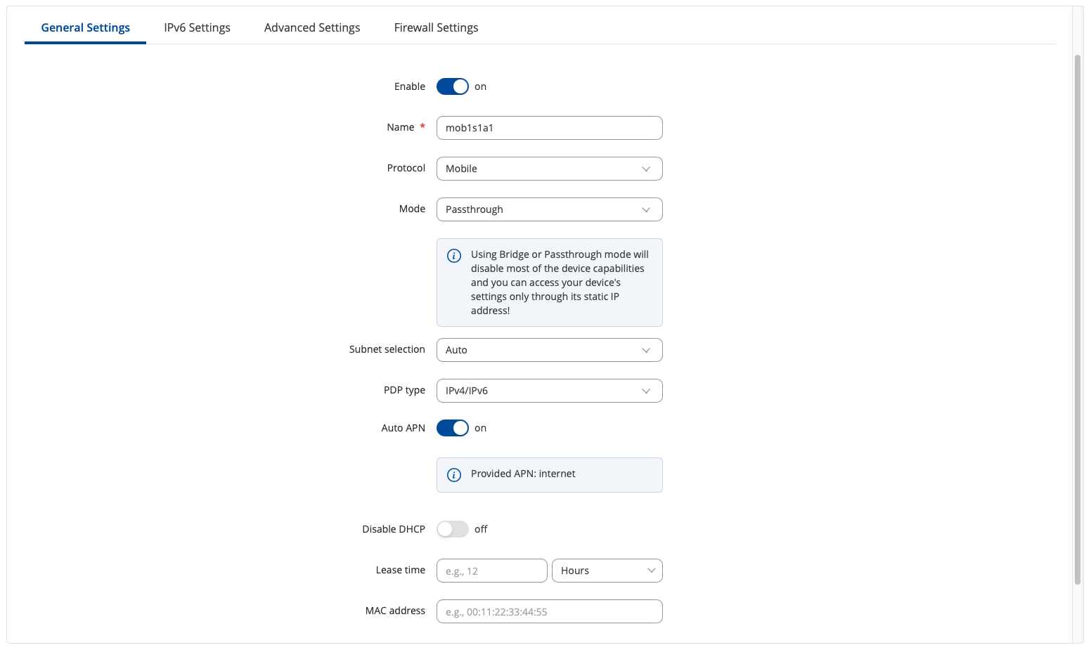

I have connected it to the failover port on my Dream Machine Pro and set the Teltonika as Passthrough
WAN > mob1s1a1
Mode - Passthrough
LAN > lan
Enable DHCPv4 - off
Enable DHCPv6 - off

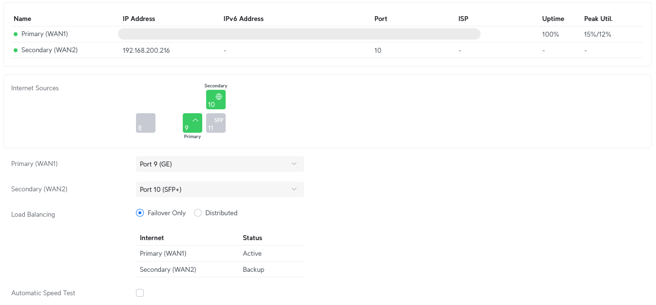

My Dream Machine Pro sees the signal but shows the internal ip.
Shouldn’t this be my public ip of the 5G signal?
Or did i setup something wrong?

TRB500 WAN: I have PDP type set to IPv4, lease time to 2 minutes, MAC address set for the UDM WAN port.
TRB500 LAN: PDP type set to IPv4 and Enable DHCPv4 turned on.

Thank you! I changed some settings on the TRB500 like you said and with the Teltonika TRB500 connected to the wan2 port, i now get an IP address and carrier name.
Even if i enter my wan2 ip address in my browser i can connect to my server so i think it works. Thanks a lot!

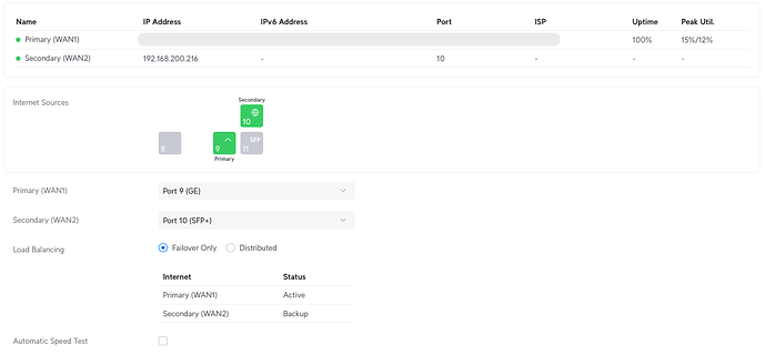

For some reason it now shows the internal ip address of the TRB500 instead of the public ip (since today on the Dream Machine Pro).
What can cause this problem?
Either the TRB500 is not getting an IP from the carrier, or it is and is not passing it through. Unfortunately, I don’t know how to debug this. Someone else might be able to help. I presume you have restarted everything.
My other TRB500 LAN settings are:
Advanced: Fore link on
Physical settings: Bridge Interfaces on.
Physical settings: Interface eth0, ecm0.
I think there was a problem with the provider. I have odido (dutch) and it had an outage.
Now the ip is back
