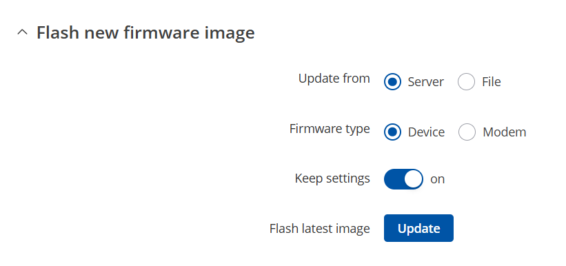

A download for the latest firmware can be found on our Wiki website here: TRB500 Firmware Downloads - Teltonika Networks Wiki
You may install it manually, or, assuming your TRB has internet, you may also opt for a “FOTA” (firmware over the air) upgrade, which downloads the firmware directly from the server. All you have to do, is login to the WebUI (Web Interface) of the TRB500, head to System → Firmware → Update firmware and click on Update:
