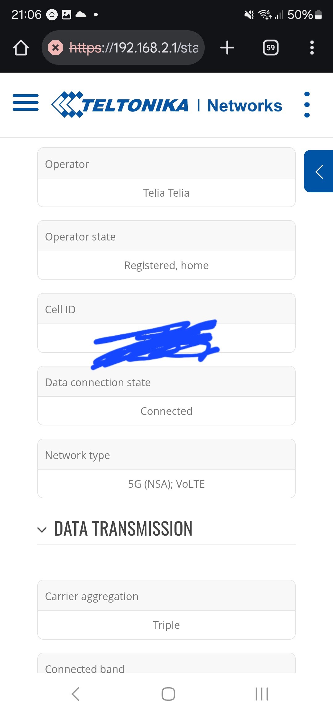

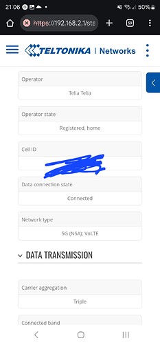

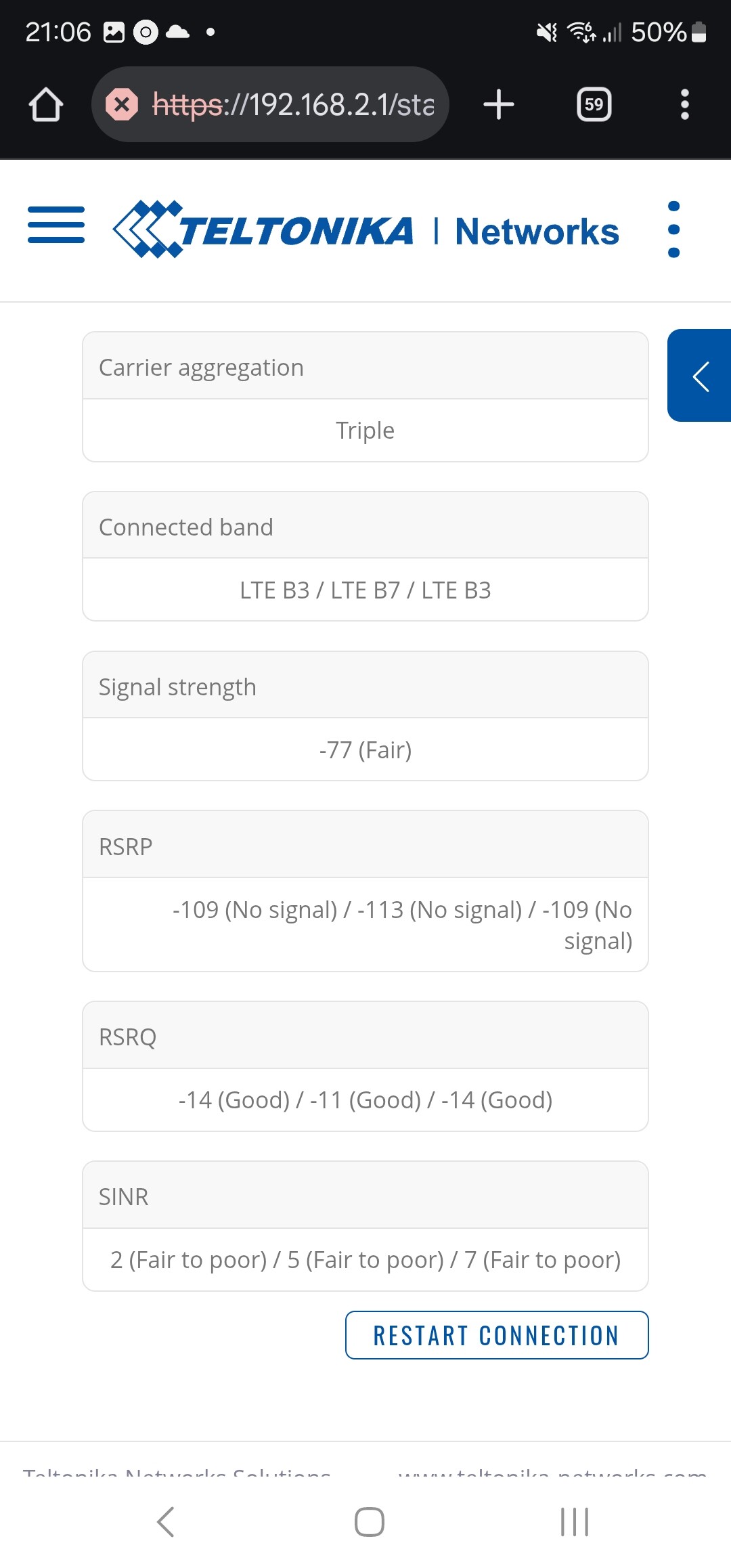

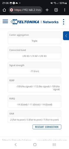

Additionally, could you provide a screenshot of the Status → Network → Mobile page from your TRB500? Please make sure to hide any sensitive details like public IP, IMSI, or ICCID before sharing.

Hi i have tried moving it outdoors and only yielded a faster upload. Tried it again today ang got faster download but not 5g speeds but similar to phone. Yes ive adjusted the antenna all 4 are fimly attached
Antennas are connected firmly, the device is running in auto right now, i sent the images in message above, i will look into the signal improvements tommorow when i have time to do some real work on it
From screenshots I can see you’re using older FW version, try updating to newest (7.15.2):
