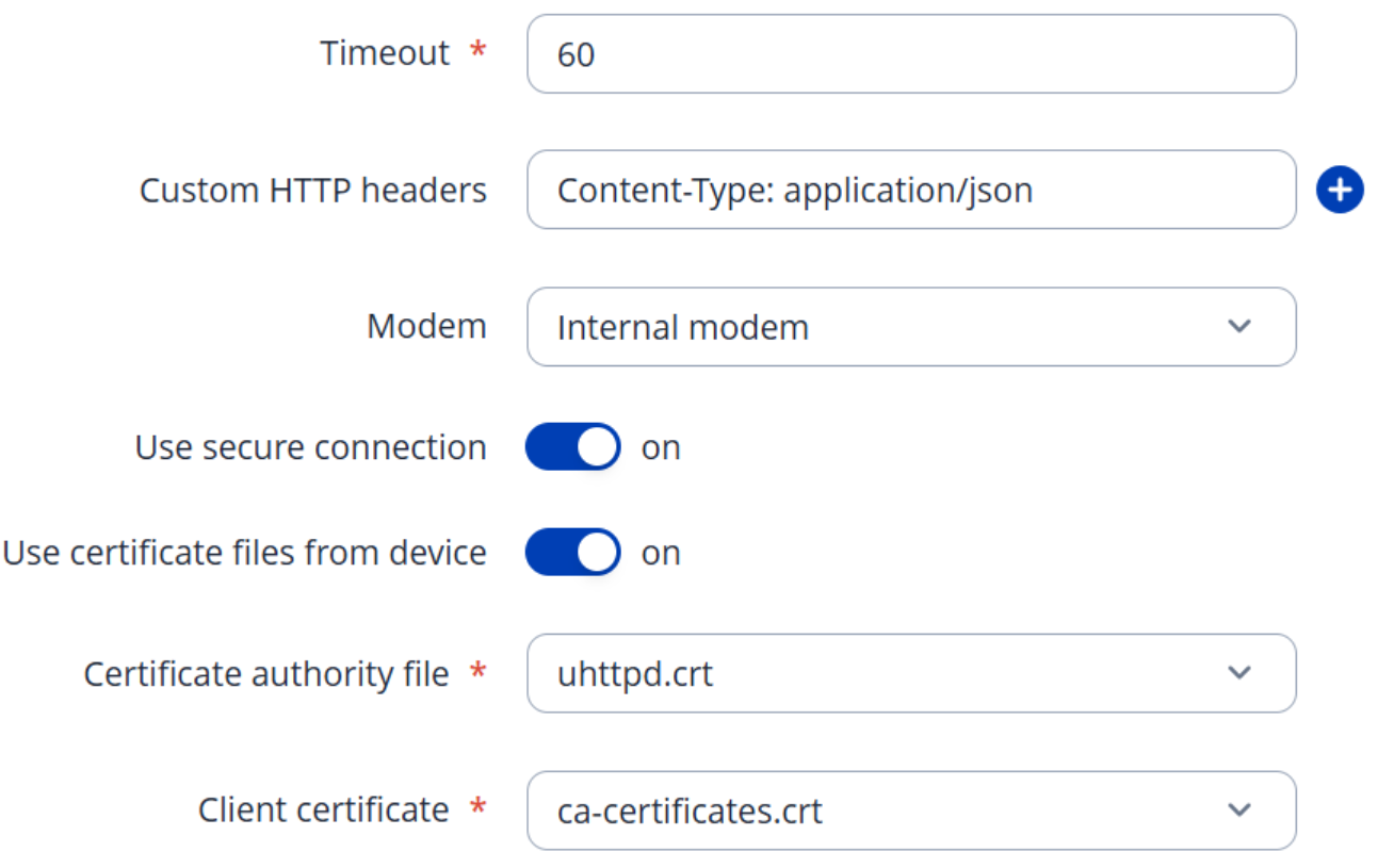

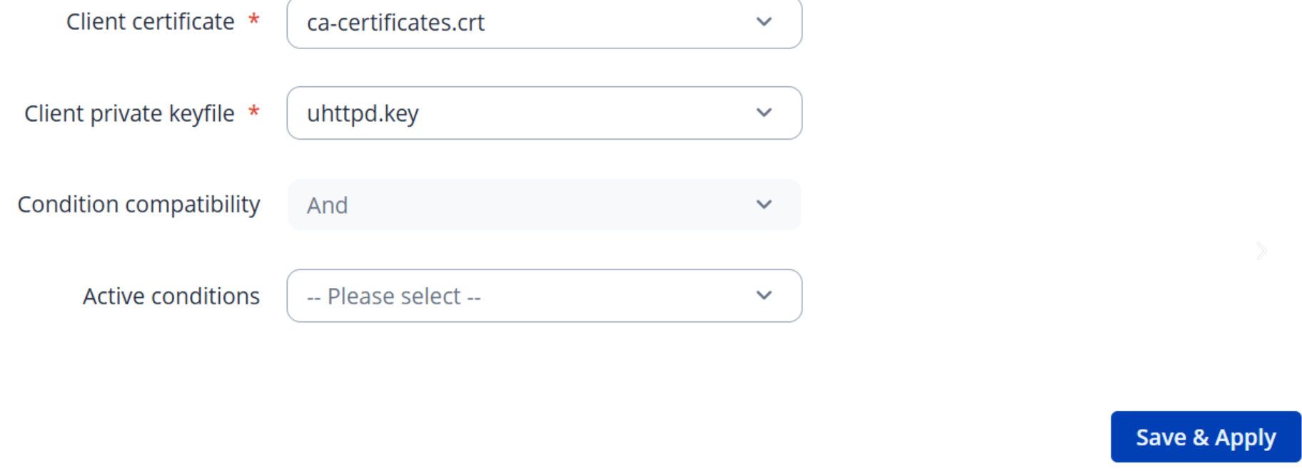

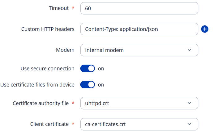

If your server cert was signed by trusted CA then just enable “Use certificate files from device” and use ca-certificates.crt that will be selected by default.

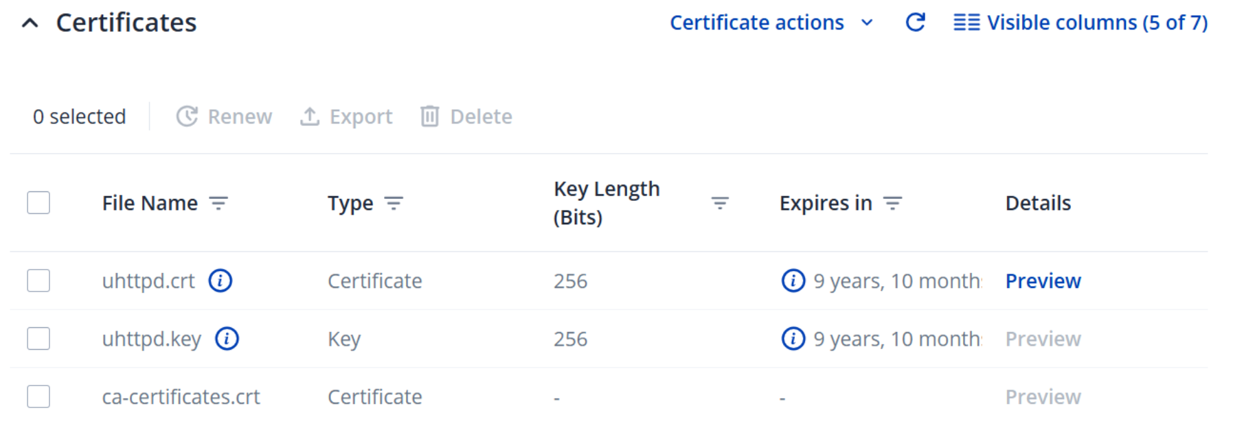

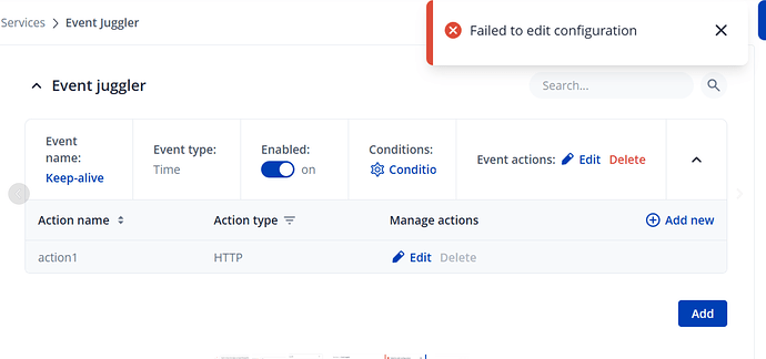

When I want to use certificates from device (both if I choose Certificate Authority File uhttpd.crt or ca-certificates.crt it Failed to save the configuration….

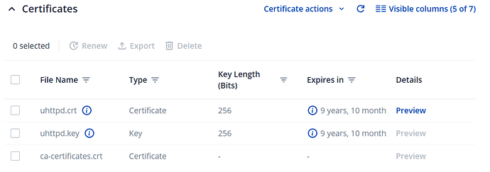

Moreover if I use certificate from the device, it will work only for 9 years and 10 months:
And my goal is to work it indefinitely…

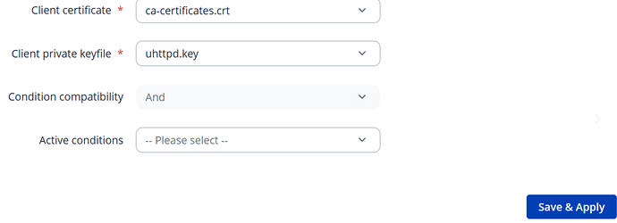

Oh I see with current release both client cert/key are required and you were using router’s https server certs that are not very valid here.

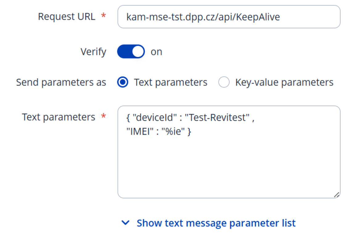

If you are looking for insecure https I think that you can disable “Verify”, “Use secure connection” and use protocol in request url field like https://kam-mse-tst.dpp.cz/api/KeepAlive. If not then I am not sure what to recommend at this time. Although dev FW that I was using no longer had this problem.
As far as further TLS problems I afraid this is where my knowledge ends :S But from your logs seems like tls is downgraded by server not client.
I cannot save configuration when I check “Use secure connection” without uploading certificate or choosing one from device…
I meant - you can disable it and add https:// proto to url in order to achieve insecure https.
but when I just add https:// to url it does not work - no meter if “Verify” is checked or not. In logs I can see:
