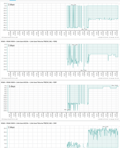

We are experiencing issues with several TRB255/256 units in the field where the devices do not always switch to the strongest available LTE-M cell, sometimes remaining on a weaker tower much longer than expected. You can see the tower stays on a much weaker signal far too long despite the other, better signal being available. These are stationary devices.

  • WebUI shows no modem firmware updates available.
  • The devices are generally stable, but reselection behavior is suboptimal to say the least in some areas.
