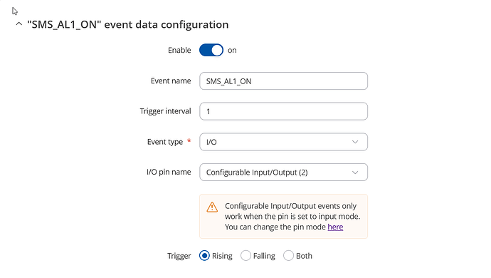

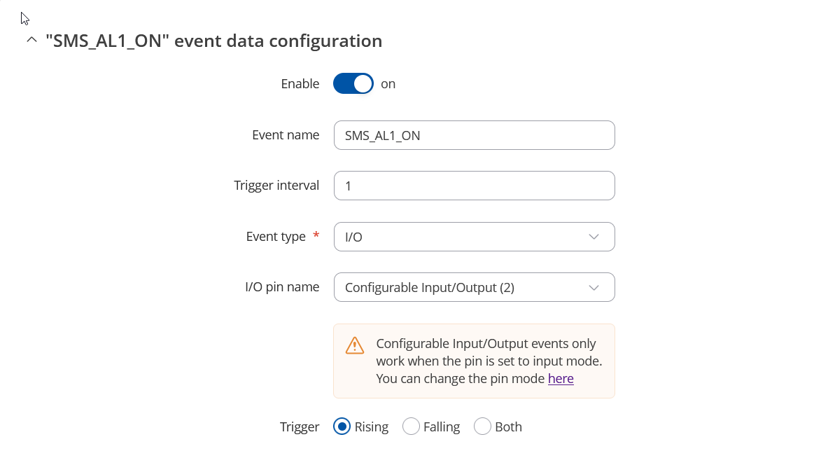

  • I created a new event with the following parameters
    • Event name: SMS_AL1_ON
    • Trigger interval: 1
    • Event type: I/O
    • I/O pin name: Configurable Input/Output (2)
    • Trigger: Rising

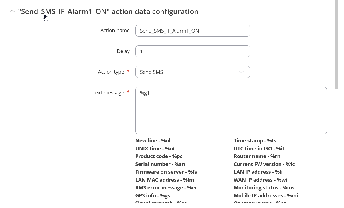

  1. Action Data Configuration
  • Action name: Send_SMS_IF_Alarm1_ON
  • Action type: “Send SMS”
  • Text message: %g1

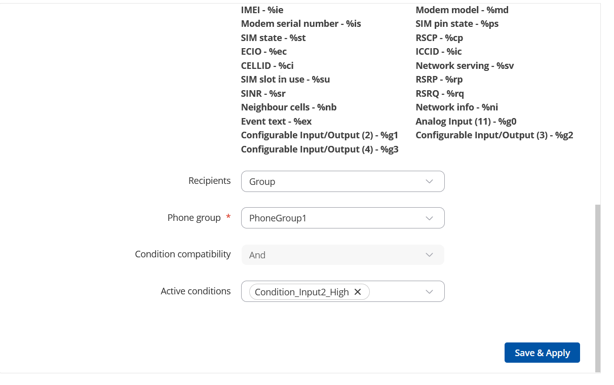

  • Recipients: “Group” (Phone group: PhoneGroup1)
  • Condition compatibility: “And”

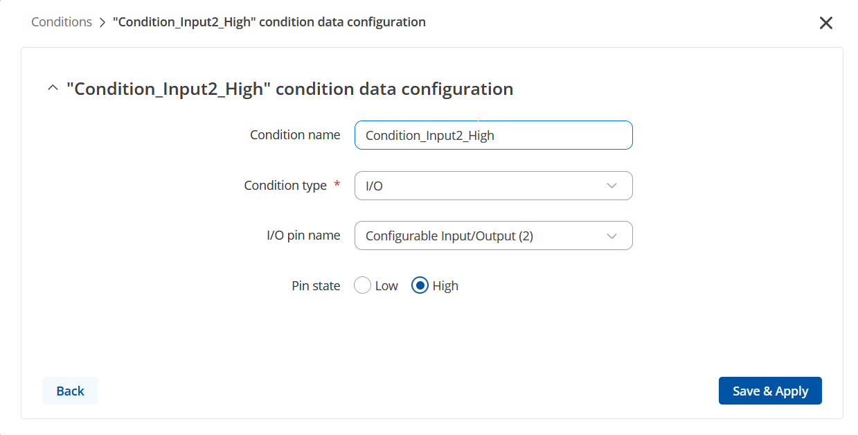

  • Active conditions: Condition_Input2_High

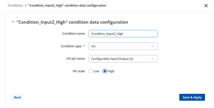

  1. Condition Configuration
  • Condition name: Condition_Input2_High
  • Condition type: I/O
  • Pin state: High
Despite this setup, I receive random SMS messages showing “Low” at unpredictable times. I specifically want to avoid any SMS for the Low state. Is there a particular setting I’m missing or a different approach to ensure that the device only sends “Alarm 1 ON” SMS messages for High and never sends a “Low” message?

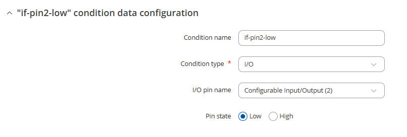

Thank you for reaching out.
First, could you confirm if Pin 2 is set as Configurable Input in the Services → Input/Output → Status page?
Additionally, for a more optimized setup, the condition should be configured to trigger an SMS only when Pin 2 state is Low, so that when it transitions to High, the SMS notification will be sent. For reference, check the screenshot below:
Let me know if this helps or further assistance is needed.
