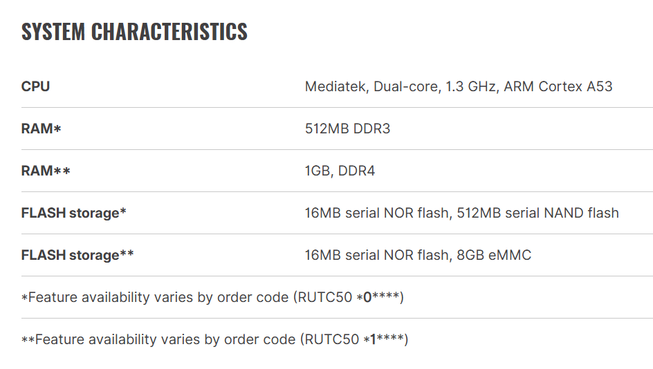

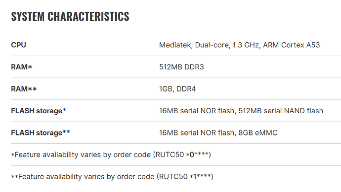

Wouldn’t necessarily call them “superior”, but I’d look into devices with USB support, you’d be able to store the logs into the USB, without having to worry about the device memory being overfilled. I’ve filtered out cellular devices with USB support for you: https://www.teltonika-networks.com/products?features=205&features=246
For the time being, the device with the most RAM & Flash memory is the RUTC50: https://www.teltonika-networks.com/products/routers/rutc50

The reason I’ve suggested the RUTC50 was mainly due to the fact that it has more internal memory than other devices available within our portfolio. With the use of the custom script, you could simply store those log files within the device, instead of having to rely on the USB stick that I also suggested using.
