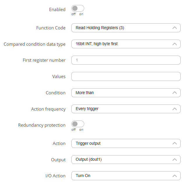

Yes, this would be configured in Modbus Alarms, and the configuration would look like so:
Yes, multiple Modbus Alarms can be configured.
