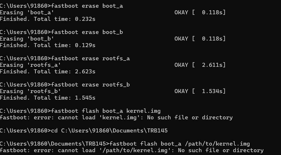

I need fast boot following file for TRB145
fastboot flash boot_a kernel.img
fastboot flash boot_b kernel.img
fastboot flash rootfs_a rootfs.ubi
fastboot flash rootfs_b rootfs.ubi
Please share the above files for resolve issue.
