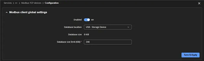

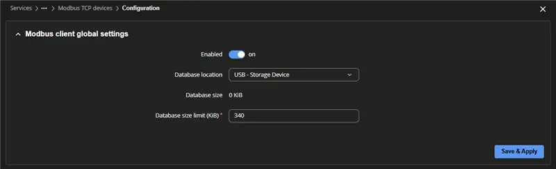

By default, the Modbus Client database on our devices is stored in RAM and has a maximum configured size of approximately 1.4 MB.
The database size and storage location can be adjusted through SSH if required. Please find the relevant information below.
Database size
The database size is not defined directly in megabytes. Instead, it is configured as a number of 4 KiB pages.
By default, the maximum database size is 340 pages, which corresponds to approximately 1.4 MB. 340 x 4 kB = ~ 1.4 MB
The database does not occupy the maximum amount of memory immediately. It starts with a smaller allocation and grows as data is added until the configured maximum is reached. Once the maximum size is reached, older entries are removed to make room for new data.
The currently allocated database size can also be checked over SSH using the following debug command:
modbus_client -D 5
To increase the maximum database size, the /etc/config/modbus_client configuration file can be edited. Under the main section, add or modify the following option:
option db_max_page_count '2560'
For example, a value of 2560 corresponds to approximately 10 MiB.
Please note that when the database is stored in RAM, increasing its maximum size also increases the potential RAM usage of the Modbus service. Therefore, the configured database size should be selected according to the available RAM and the other services running on the device. We recommend avoiding unnecessarily large allocations, particularly on devices with limited RAM.

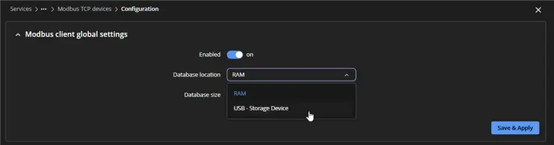

Database storage location
The default database location is RAM.
If external storage, such as an SD card or USB drive, is available, the Modbus database location can be changed through:
Services → Modbus → Modbus TCP/Serial Client → Global settings
When external storage is selected, the maximum database size can also be configured from the same menu. In this interface, the database size is specified in KiB, rather than in 4 KiB pages.
The router’s internal flash storage is not available as a selectable database location through the WebUI. If there is a specific requirement to store the Modbus database in internal flash, this can instead be configured through SSH by modifying /etc/config/modbus_client.

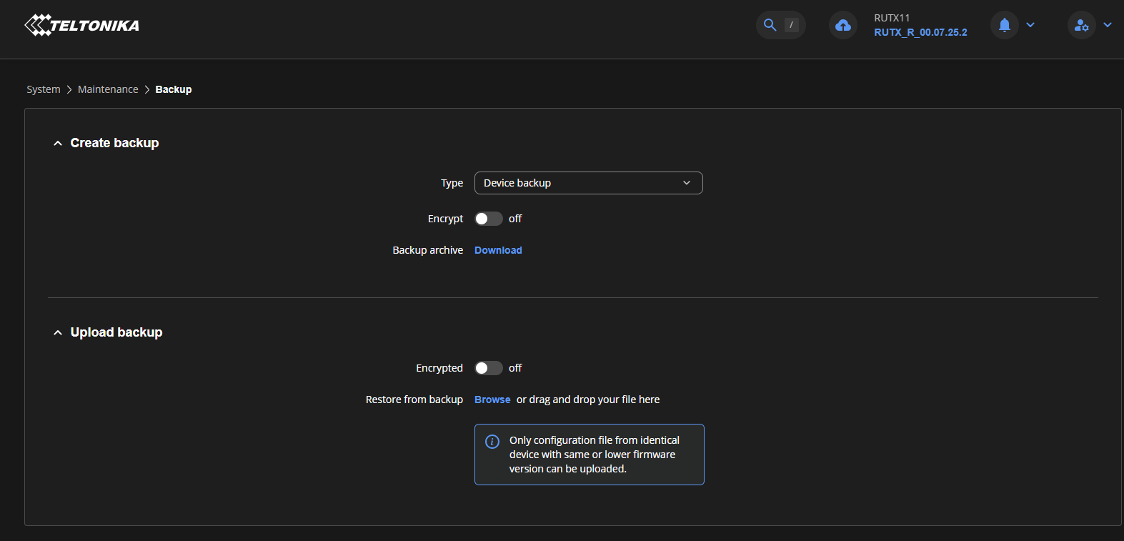

Precautions before a major firmware upgrade
If the Modbus configuration and accumulated database data are important, we recommend taking both of the following precautions before a major firmware upgrade.
First, create a standard device backup through System → Maintenance → Backup. This is the recommended way to preserve the device configuration. When performing the firmware upgrade, the Keep settings option should be used where supported and appropriate.
Second, as an additional precaution, make a separate copy of the Modbus-specific configuration file:
and a copy of the Modbus database file from its current location. These files should be stored externally before starting the firmware upgrade.
This is particularly advisable when the historical Modbus data must be retained.
The /etc/config/modbus_client copy provides an additional reference for the Modbus-specific configuration, while the database copy preserves the accumulated Modbus data independently of the firmware upgrade.
Please note that we do not recommend relying solely on a manually copied database file as a guaranteed restore mechanism across major firmware versions. Database compatibility and migration may depend on the specific firmware versions involved.
