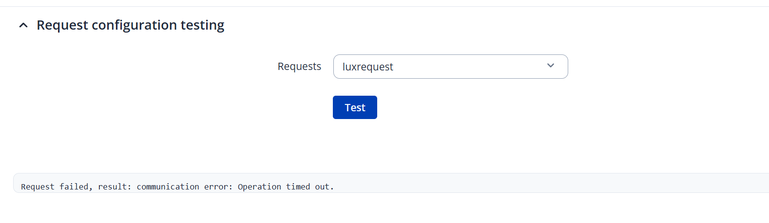

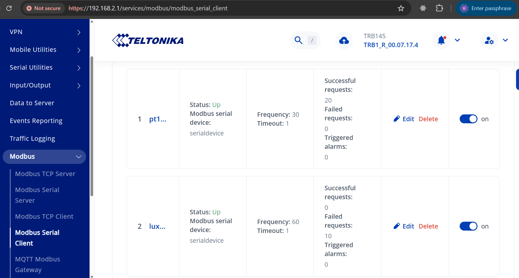

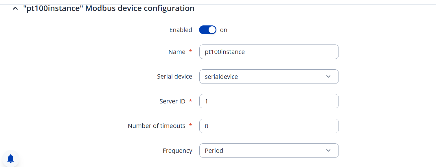

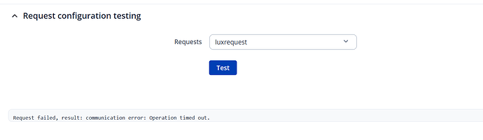

I have added two devices 1. RS485 Lux sensor (slave id 2) 2. RTD PT100 sensor (slave id 1). They are working independently if slave id is set as 1. But when I add slave id other than 1, they are not working. Im looking for two devices to work in parallel.
Could you please try increasing the timeout value for the second serial sensor device and observe if that changes the behavior?
For testing purposes, you could also try setting the first serial server’s ID to 0 and the second to 1.
Just to confirm, when both sensor devices have their server ID set to 1, the serial communication works correctly, right?
