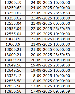

We are using TRB145 as modbus serial cllient with selected “Schedule: 10:00:00” in “Frequency” tab. Our client wants once a day at 10 a.m. to read a value. We are sending that value through MQTT with “data to server“ and save it to database on our server. Everything works okey, every day we have a value at 10:00:00 but sometimes we have values also at 09:59:59, 00:00:00 or 23:59:59. When this happens I go to teltonika device and see that there is more than one request per day when it should be exactly one at 10:00:00. Cant find why is that?

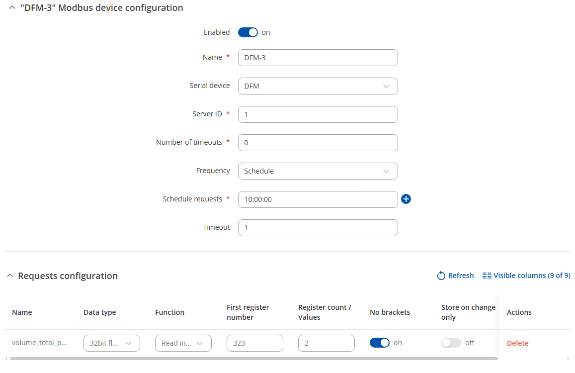

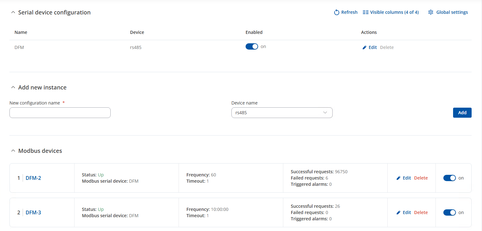

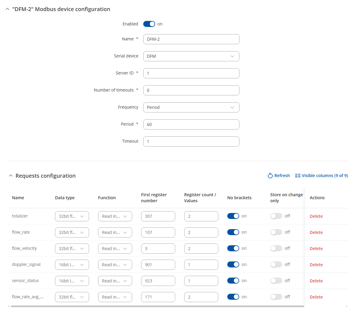

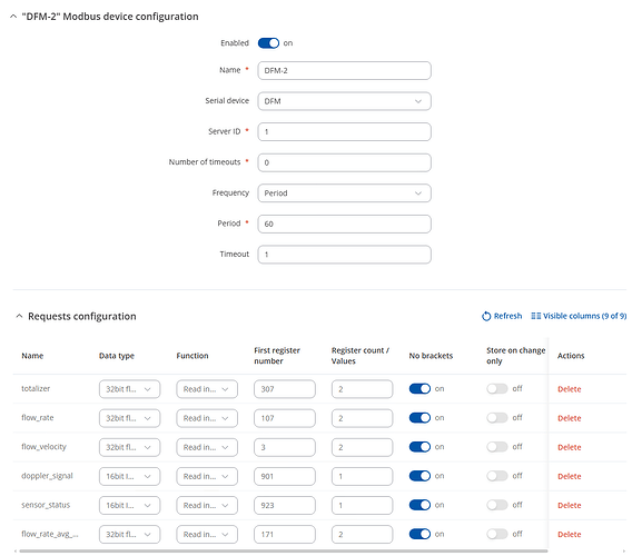

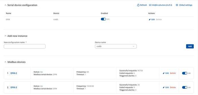

Modbus Serial Client configuration: I have one modbus serial device (DFM) and 2 configurations with different frequency (DFM-2,DFM-3) connected to it. The first one is on 60 seconds period with 6 parameters and the second one is on schedule at 10:00:00 with only one parameter.

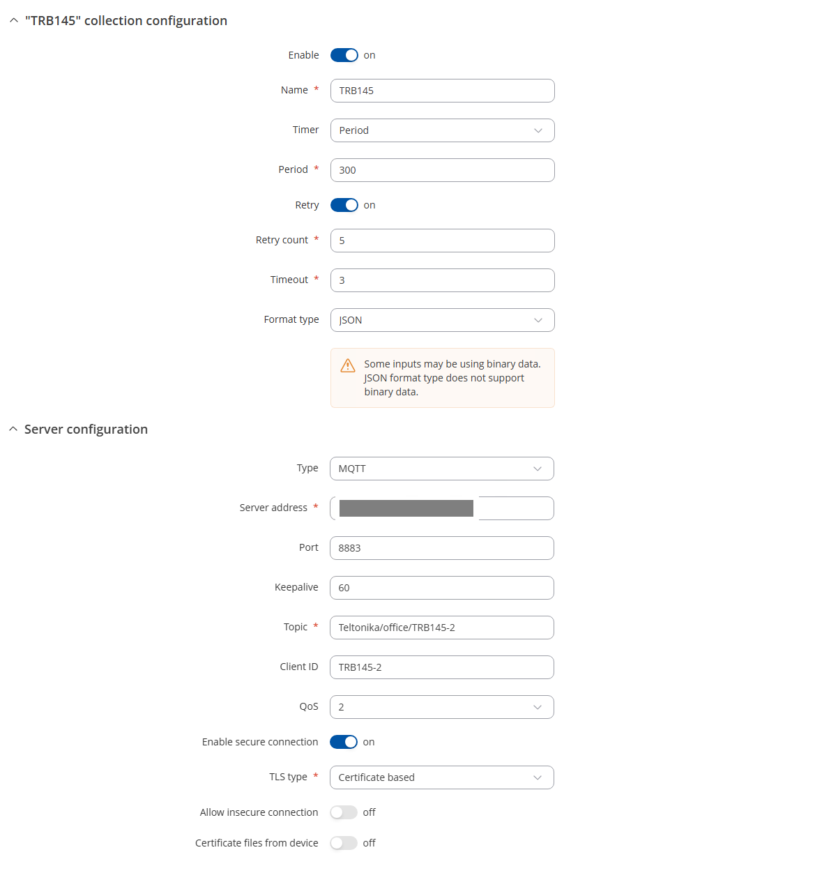

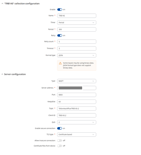

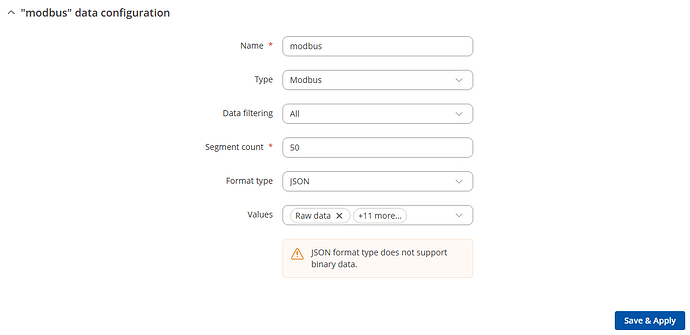

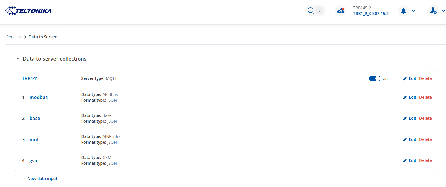

Data to server configuration: type MQTT with 5 min period to send all data collected from modbus parameters.

If so, as I understand, both of these Modbus Serial Client configurations are for the same physical meter, correct? In that case, please try increasing the timeout values to 5 and, for testing purposes, set the QoS parameter in the Data to Server configuration tab to 0.

Yes, both of these Modbus Serial Client configurations are for the same physical meter. But we have multiple physical meters with the same configuration and the discrepancy is the same everywhere.
