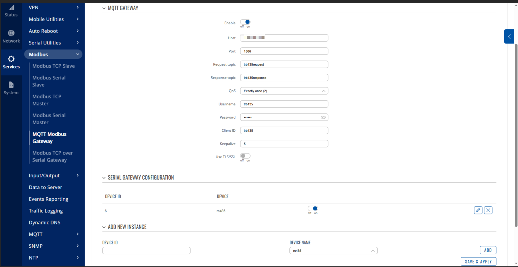

Hi guys! im trying read equipment archive data by MQTT modbus Gateway but unfortunately TRB 145 cant read modbus Enron format is there way to send RX data from device without decoding (like thiss 01 04 88 BE 00 02 3A 4F 01 04 04 00 00 BC 35 4B 53) i would decode it by myself on mqtt server

  • a screenshot of your Modbus request configuration in the WebUI

Firmware version TRB we are using is «TRB1_R_00.07.04.5.» modem is sending information from device by MQTT Modbus gateway.Connected device is floboss 107 and it supports standard Modbus RTU but once a month we need to download history from device
