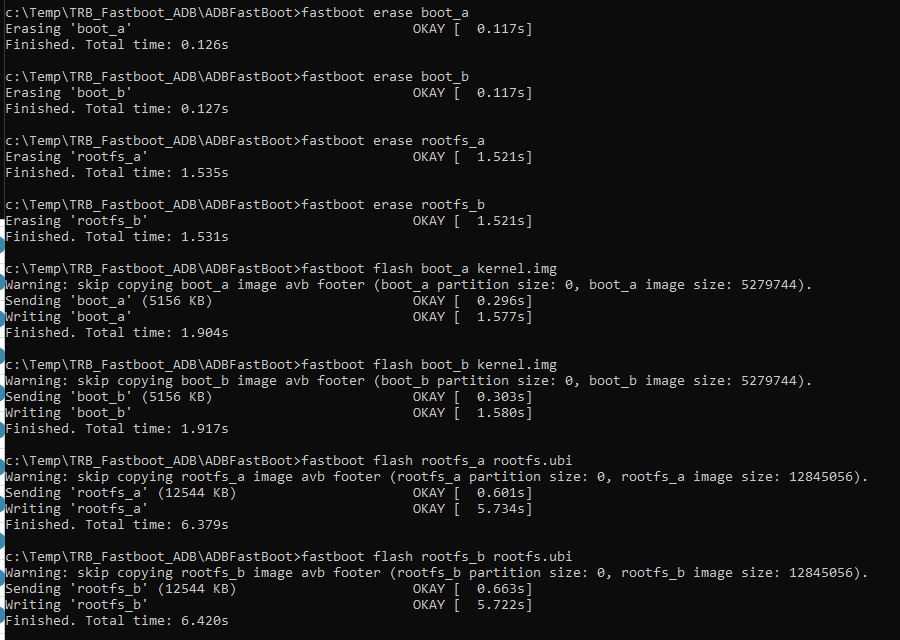

Seems all went well with loading the files as per the below.
The devices is now in a boot loop, any help will be appreciated.
Thanks,
Johann
If you’re still having trouble, you can attempt the procedure again. If nothing changes, looks like your device might be bricked. In this situation, please reach out to your reseller or Teltonika if you purchased directly from us, and we will start the RMA procedure.
