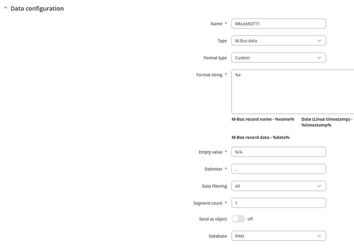

Could you please share you current configurations? Before you share them here, make sure you hide/blur any sensitive information, like public IPs, connection strings, passwords, etc.
Hi AndzejJ
I have tried both the “Data to other Server” and also the “MQTT Publisher” with the right certificates in place according to the old guide for ModBus I linked to in my first post.
The platform I try to use is HiveMQ MQTT Broker service, just like in the older Modbus guide.
I use wired ethernet that has a working internet connection. No GSM.
Hello @ingo69,
It seems that you have port 1883 configured. Could you please try setting in to port 8883?
If this does not help, HiveMQ should have a public broker available that can be used without TLS. Could you please try that and see if it works? This will help us to see if the issue is with Certs/TLS/Authentincation.
