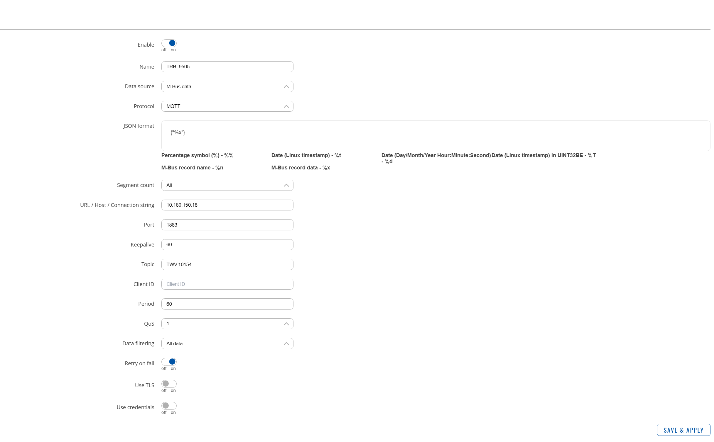

I’m trying to readout heat meters with M-Bus. The TRB is connected to the meter and is successfully recieving the data. I’m using a RUT240 as a MQTT Broker, if I test this Broker, it’s functioning as well. But the TRB is not sending any data. I configured it as in the examples in the teltonika wiki descripted.

Could you attach the screenshots of your Mbus and Data to Server configuration? This may help me better understand the issue you’re currently facing.
A few things to make sure:

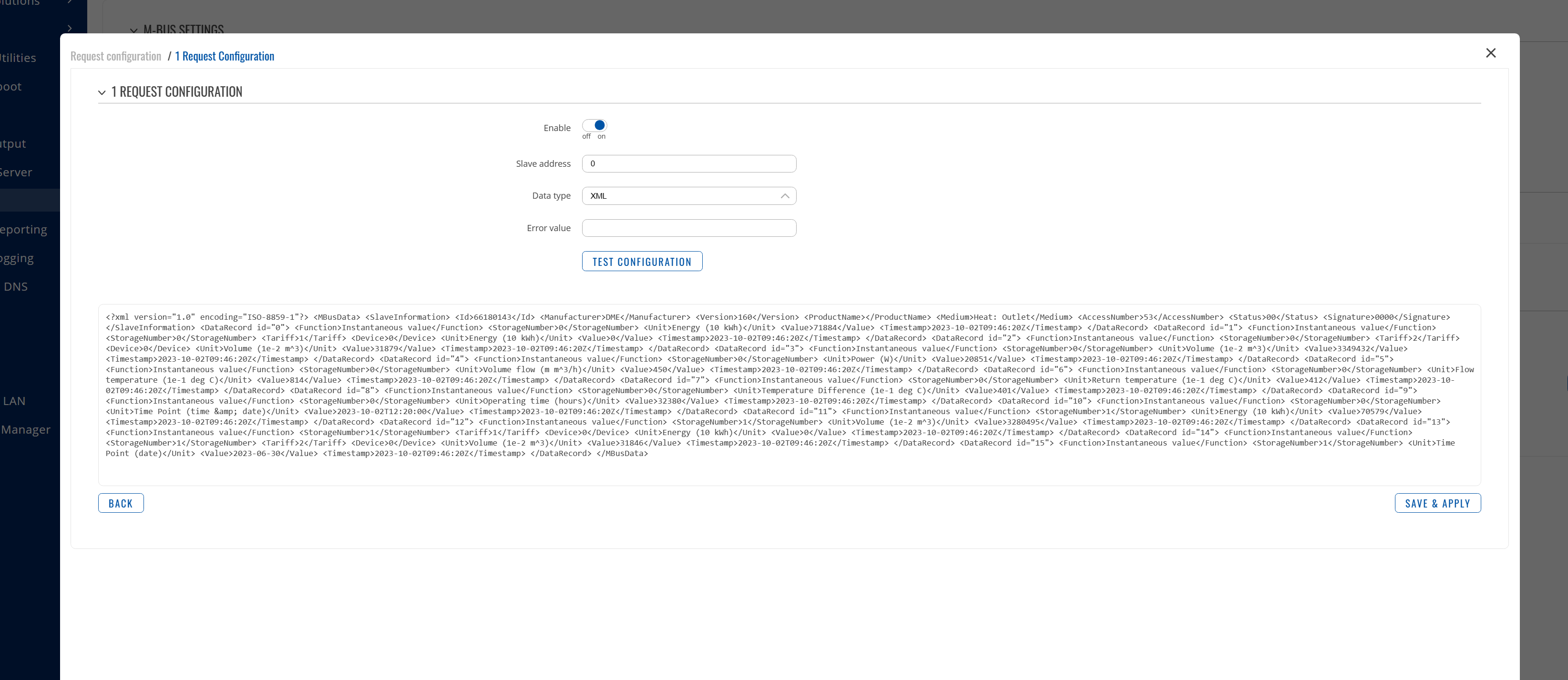

  • Make sure the Mbus data is getting read correctly from the device by pressing the Test Configuration button in the Mbus configuration menu;
  • Make sure your JSON template is not empty in the Data to Server configuration;

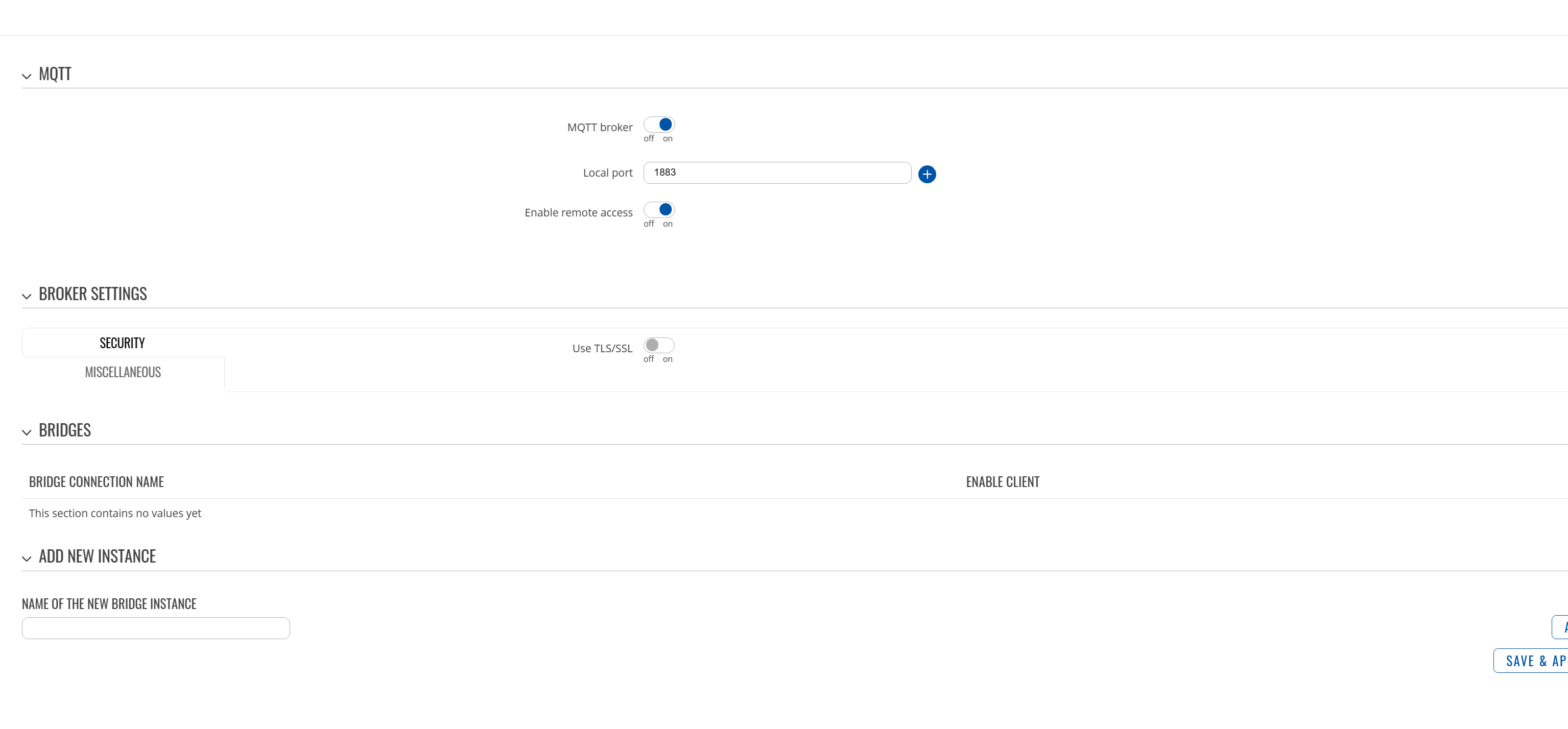

  • Since you’re using the Broker on RUT240, make sure that Enable remote access option is enabled in the Broker configuration.
i get the correct data from the meter not on every try, it’s about every 10th.

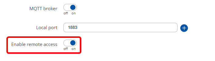

If it’s the SIM in the RUT240, then you will simply need to enable the remote access option:
And use it’s mobile IP for access.

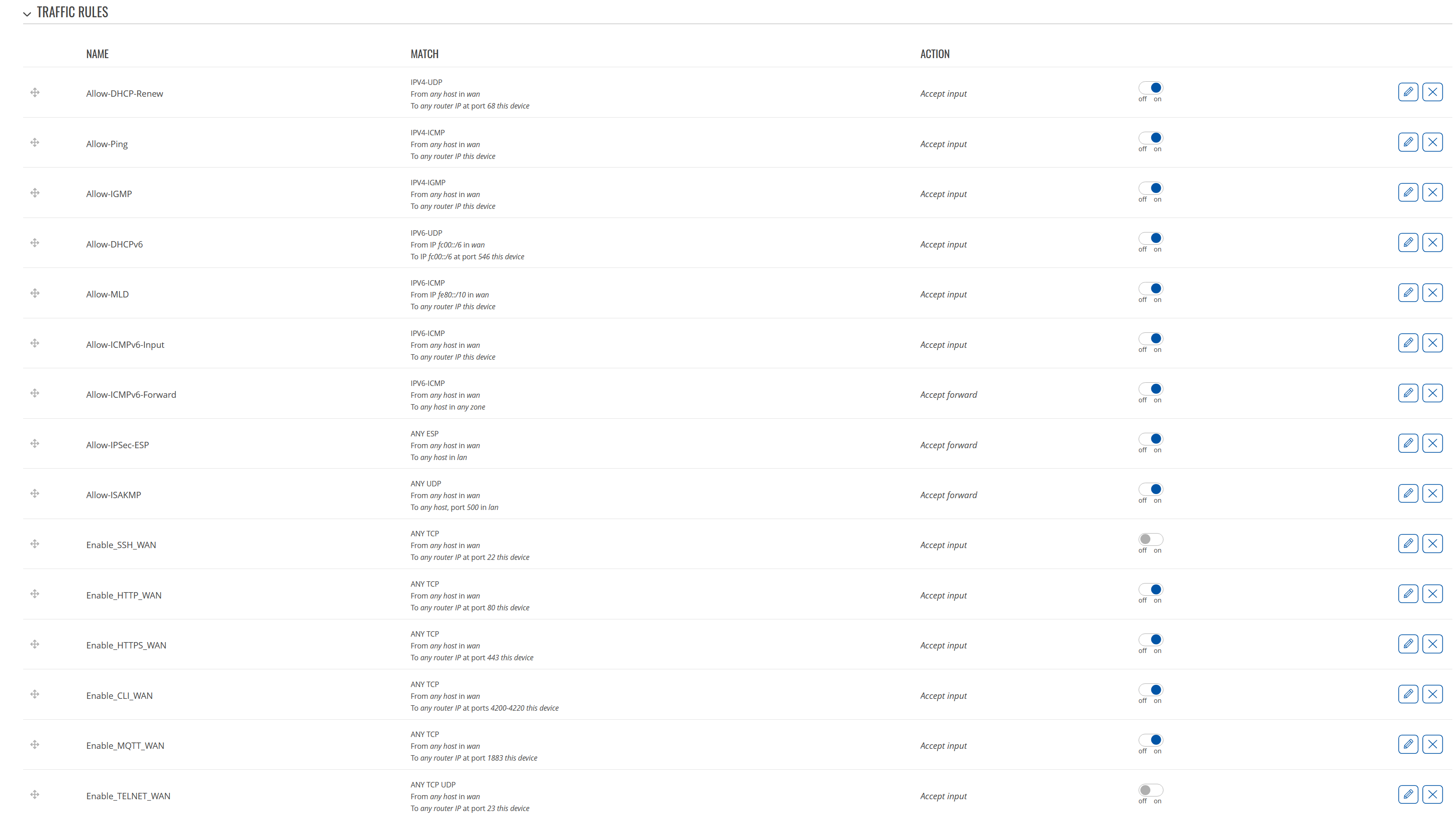

Please provide the screenshots of the RUT240 MQTT Broker settings, as well as the traffic rules found in the Network → Firewall → Traffic Rules menu. Please also provide the mobile IP addresses of both devices (since they are in the private range, they shouldn’t be reachable from anywhere else).
