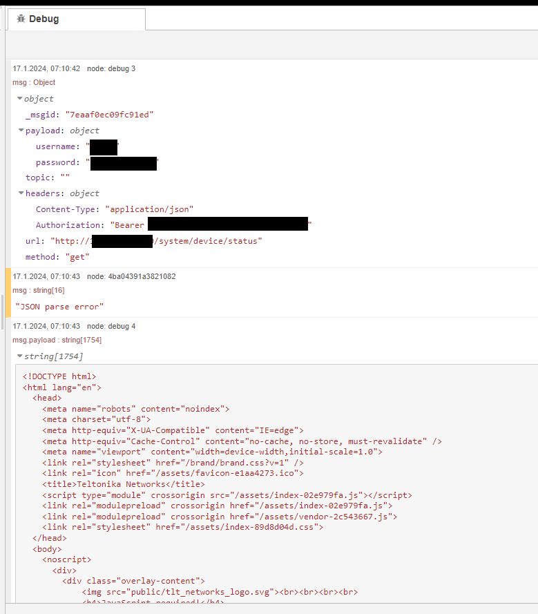

TRB143 API not working
does the API für the TRB143 work?
I send a http-request from node red. But I only get back a html-string.
The request to get the token works.
Is there maybe something wrong?
In the picture you can see my request an the response.
Thank you for help.

Tanks for your help.
In the request-url i forgot the “/api”. Now it works perfectly.
Sorry :laughing:
