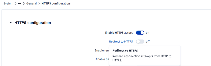

For testing purposes, please try the following:
- Disable Software Flow Offloading by navigating to Network → Firewall → Settings , then check whether the issue still occurs.
- Test using HTTP instead of HTTPS :
- Go to System → Administration → Access Control
- Click Edit on HTTPS
- Disable Redirect to HTTPS
The problem persists on version 7.20.3.
There haven’t been any recent configuration changes.
All our modems use the same configuration; only the VPN file differs.
There are no scheduled reboot pings.
I can’t find the SFO option in the indicated menu; there are only the invalid packet and conntrack helper options.
Using HTTP gives better results, as if the amount of data or the packet size affects the mobile process restart.
