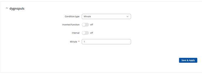

TRB141 time conditions don't send sms
I’ve been trying to set up a TRB141 as a remote level alarm sender. I’m reading an input from a level switch, sending an sms when it turns high and another when it turns low. That works fine! However, these sometimes looses connection, gets drowned or otherwise stops working. I need a cyclical sms with a custom text sent every day as a watchdog to our system. I’ve tried using a minute condition (for testing, later an hour condition) and using that to send the sms, but it never sends it. From my understanding if the condition is “1” minute, the condition will be considered high from XX:01:00 to XX:01:59 every hour. I’ve tried using the condition for a relay to see if the time condition works, it doesnt. I’ve tried using a digital input to trigger the SMS and it sends it.
Is my understanding of the time conditions wrong or is there anything else I’ve missed?

1: TRB1_R_00.07.06.10
2: see attached
3: SMS is set in the I/O juggler as an action to send when the condition above is met. I’ve seen no alternatives for edge triggering.
4: Yes, ive synced it from the browser and when i load that page later, the time is keeping up.
5: Yes, it was configured the same way, and none of the will work.
