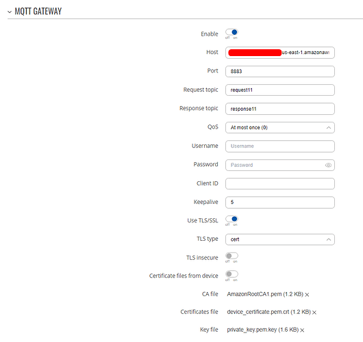

My TRB141 won’t send any data to the AWS iot Core mqtt broker. After creating a ‘thing’ in AWS I downloaded the certificates and uploaded to TRB141, and followed the instructions mentioned elsewhere on the teltonika forum, but I’m not receiving anything in AWS. I also tried using the same certificates on another device (rpi using node-red) and this worked fine.
This is what my config looks like:

I’m not using username/password. I’m using CA+certificate+key files. Yes I tried the insecure option, it didn’t change anything. I notice that in some screenshots the QOS is set to 2 - is this a requirement?
I have used Data to Server, which in a previous firmware did work but now does not. What I really need to work is the MQTT Modbus gateway, because I need to send commands over MQtt to the device. And finally, yes using another mqtt broker (using username and password) all of this works.
