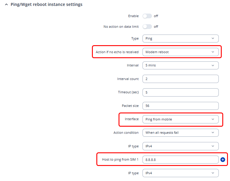

A few suggestions I’d have for you to test out:
  1. If you wish, you could upgrade one of the firmwares for your TRB to 7.19.1 to see if the result imrpoves: TRB141 Firmware Downloads - Teltonika Networks Wiki
  2. Head to your WebUI → System → Maintenance → Auto-reboot and set up a rule under the Ping/Wget section that would look like the following:
