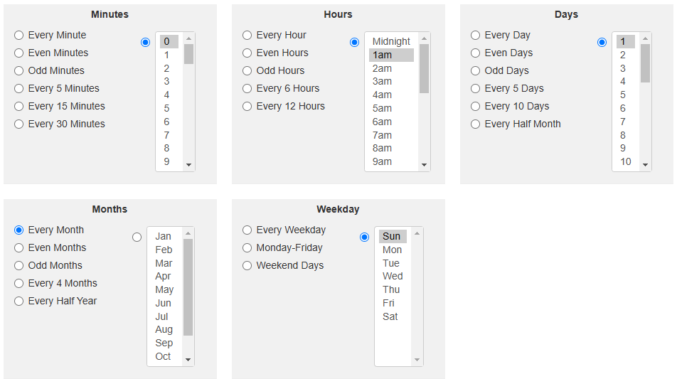

The simplest way to automate SMS sending is by using Crontabs. You can generate a crontab job to execute at your desired schedule using this online tool: Crontab Generator.

For reference, here is a crontab job example that sends an SMS every Sunday at 1 AM, starting from the first day of the month:
