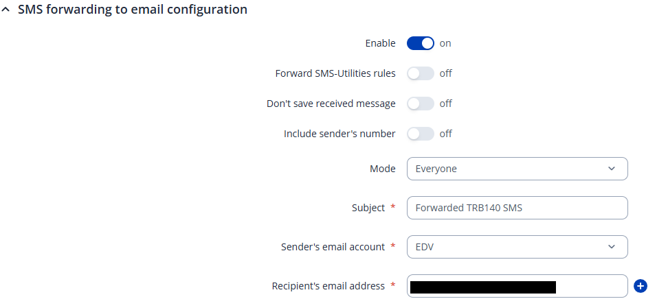

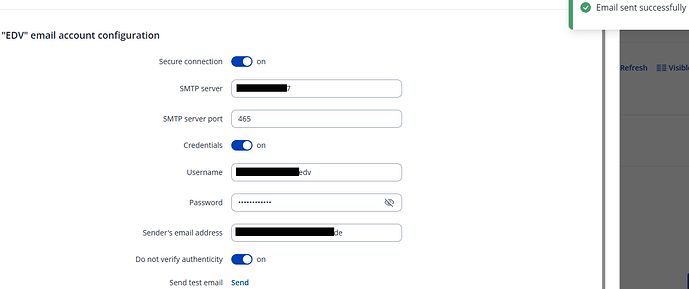

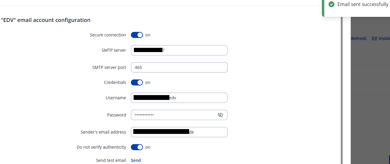

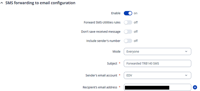

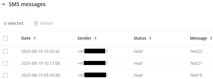

recently, i bought the TRB140 to forward SMS messages to Emailadresse and http config. After configuring the email recipient first and successully testing it. I tried to enable the forwarding function by the incoming sms. The TRB140 device receives the sms but wont deliver it the email address. Is there another configuration step necessary?
